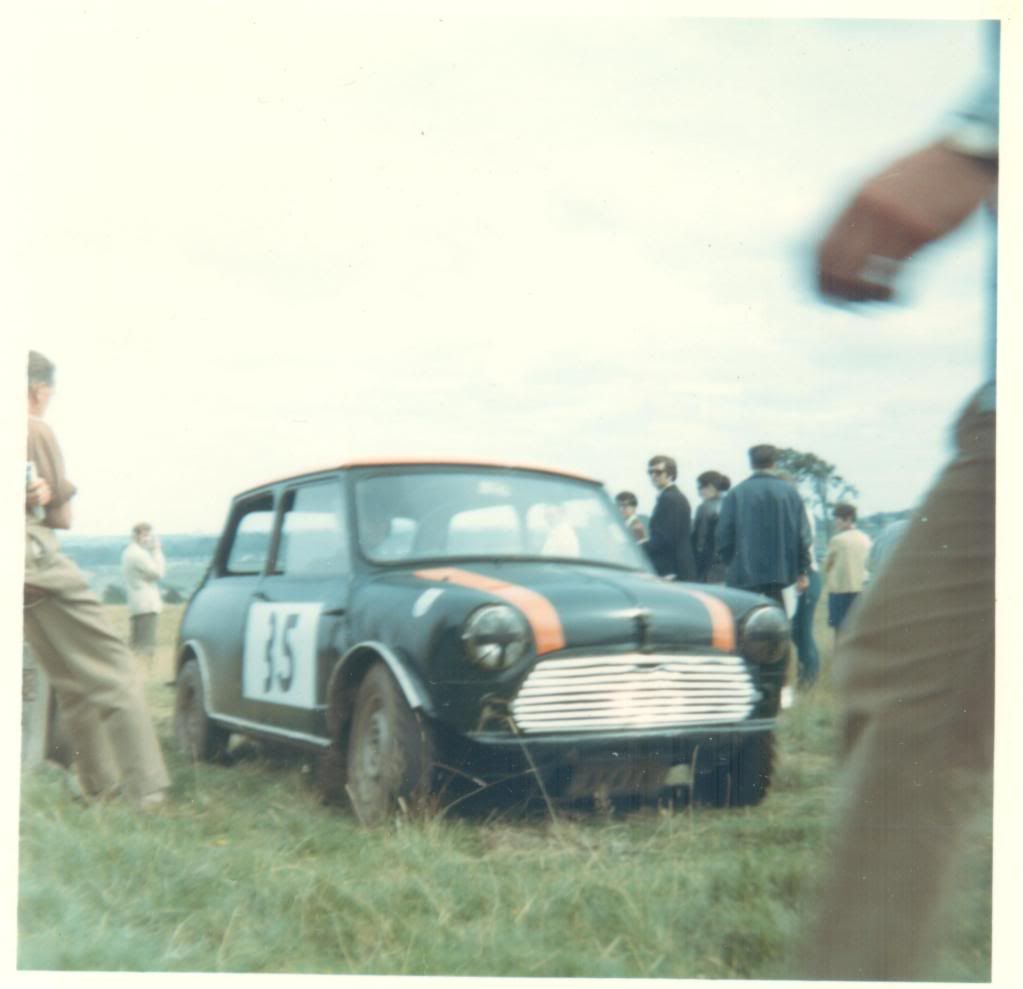

It was 40 +years ago now - we used larger hex bar, drilled and tapped them 3/8" UNF and then turned the correct taper on them. You will need to compare with a wheel to find that taper !!
These are actually Viva wheels in this shot - we later used Imp wheels. No one else was using 12" wheels at the time - caused quite a stir!!
