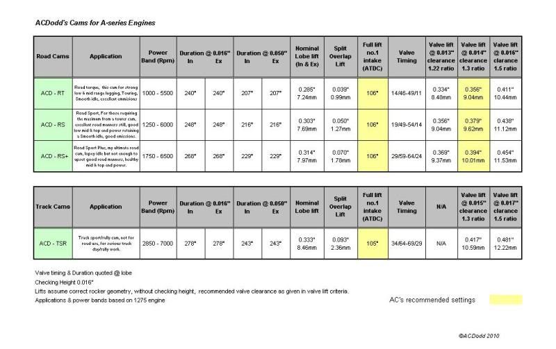

Posted 11 May 2012 - 09:20 PM
http://img.photobuck...fts/Camlist.jpg
Its a bad image but if you zoom in you should be able to make it out. I also produce 2 other cams not listed. PM your email Addy and I'll send you some up to date bumf!!
AC
