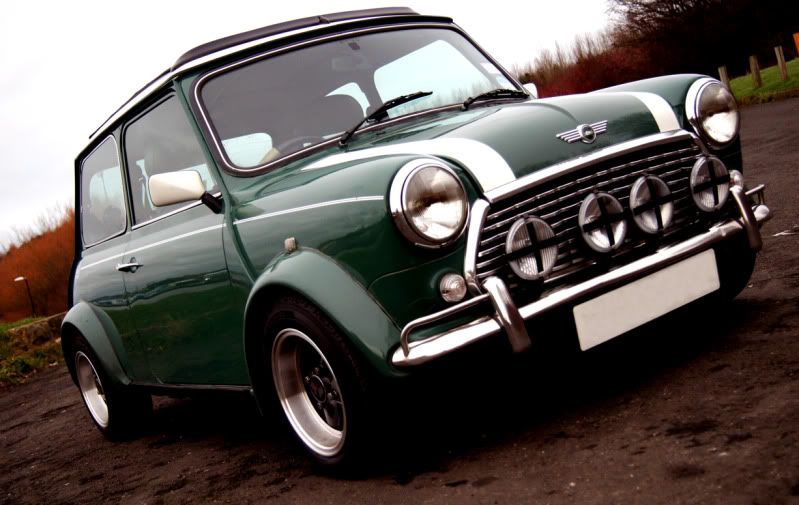

12 x 6 Revolutions....
Alex.

Thanks Miniryan09.
The 12 x 6 Revolution alloys pictured above are fitted to standard 8.4 front brake setup (no spacer) and standard rear drum and 5mm spacer fitted to Sportspack models.
My '97 Sportspack (pictured above) with 13 x 7 superlights fitted. Comparing the 2 widths and how they 'fill' the sportspack arch, then the 12 x 6's would need a spacer fitted. I fitted them for winter use....
A side shot of 13x7 Superlights on my Cooper Sport with Sportspack arches
Standard 13 x 6 Rover Cooper Sportspack alloys as reference
I know you requested 12 x 6 photos but it was to demonstrate the widths etc. :-)
Alex
