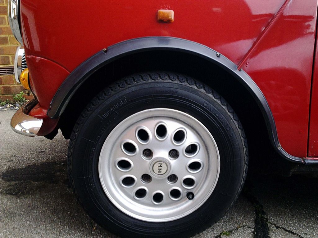

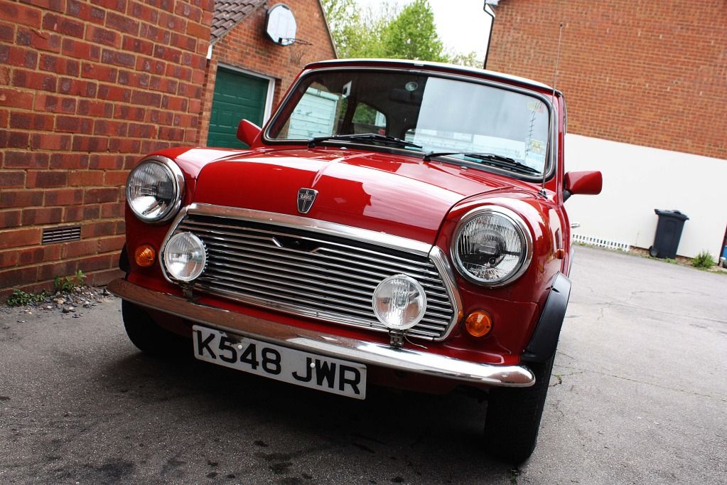

Just a quick one. When it comes to wheels - Im cluelss. I have no idea what size mine are but I am looking at getting Minilites and slightly wider arches.
Can anyone please tell me what size wheels and arches I have and also suggest what sizes I can upgrade to without having to cut the body to allow for rub etc.
Any help would be fantastic! Thanks :D
Heres some pics of what I've currently got.

youve got standard rover arches at the min, pepperpot alloys which i believe are 12x5
#3 Ryang556
Ryang556
  • 2,747 posts
  • Location: Worcestershire
  • Local Club: Top Mini
Posted 17 May 2012 - 01:51 PM
You can fit 12x5's and you shouldn't have to modify the body, you could also fit group 2 arches with them from huddersfield mini spares that go in the existing holes that will give it a slightly wider look :D
Those are a 4.5x12.
You can generally get away with 5x12's on the standard arches

Wow JP you still have the old pirelli cinturato CN54 which were factory fitment at the time..145/70r12 is the size.
Nice looking tyres, but no road holding with them and scary in the wet :P
