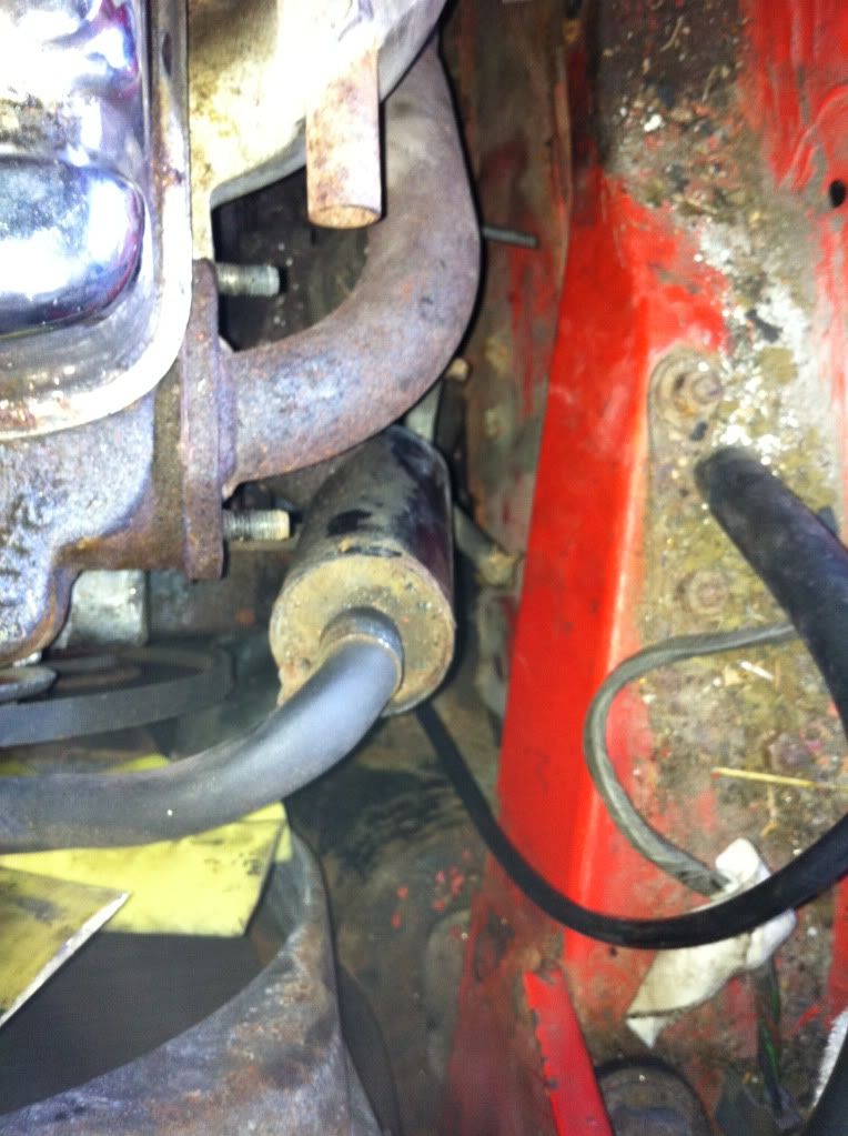

#12 CBJ805T
CBJ805T
  • 438 posts
  • Location: Kenilworth
Posted 18 June 2012 - 11:29 AM
It connects to the breather which, on my '84 mini, is mounted to a plate on the back of the block - pic below. Some minis have this positioned near / on the clutch housing
