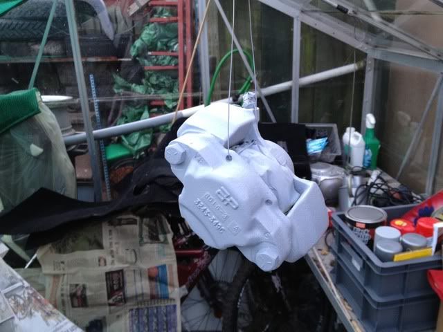

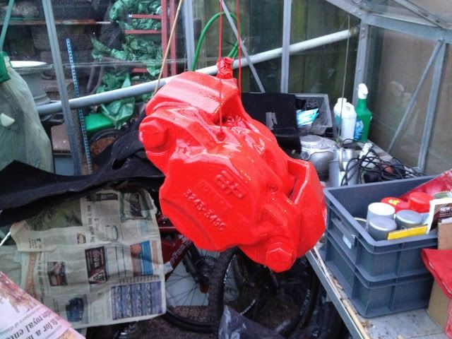

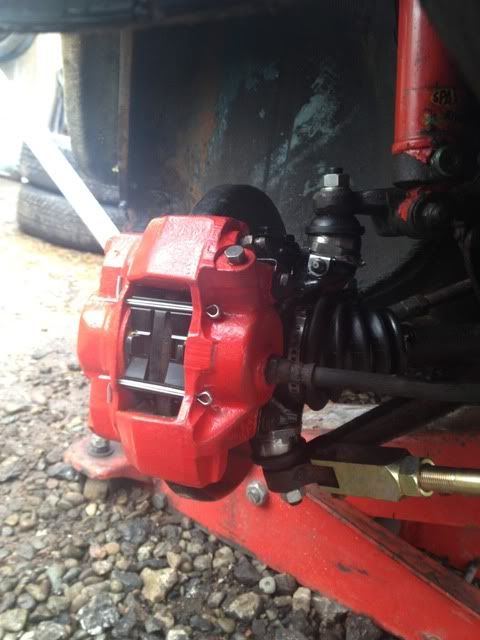

I recently painted mine masking off nipples and such like and packing out the middle piston an pad area with a cloth and then taping over that to make sure any paint didn't get past. Turned out quite well!
Primed.
Painted.
Assembled.
