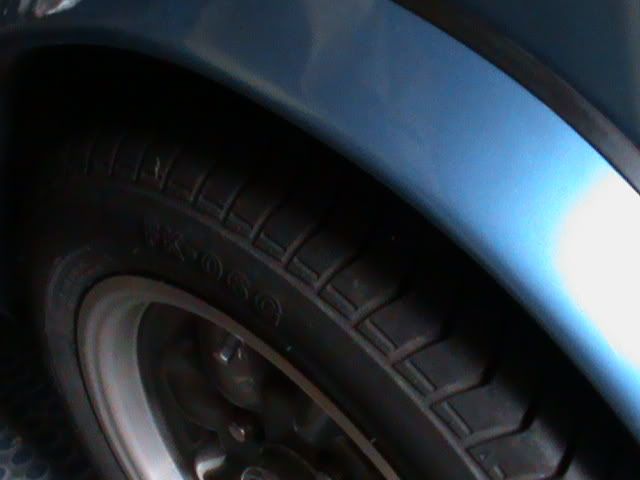

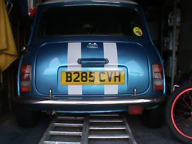

also my back ends tileted to that one side
wheel still has its geometary and aint making any wierd noises
so guessing its just a rubber cone gone?
back end
right hand side
left hand side

Try your radius arm pin to see if that has worn through the bearings. And yes it could be the cone or even a broken knuckle on the trumpet.
