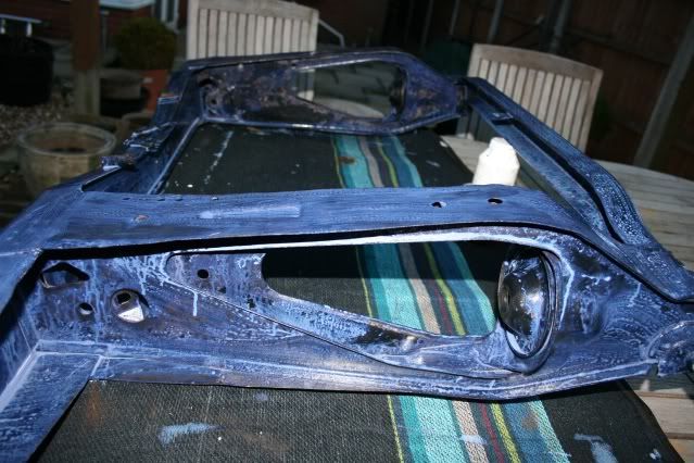

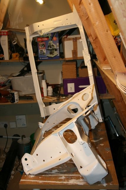

Posted 11 July 2012 - 09:05 AM
Did an electrolysis strip of the crud and rust (see internet) wire wheel to clean up and primed and hammerite. Came out fine, afterall it's a subframe not the seen bodywork and if you are not going concours then just painted will do to protect it.
electrolysis
wire brushing
kurust to get everything left
paint in white hammerite after primer
That's my way anyway !!
Graham

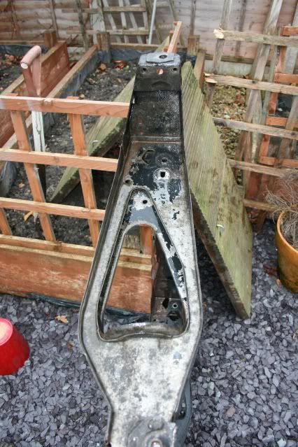

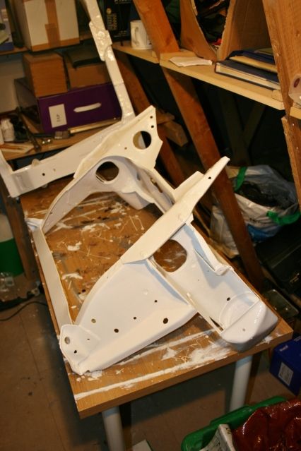

Posted 11 July 2012 - 10:05 PM
yours looks mintt, i just did mine, but went down the steam cleen because thats all i had avalable,the flapper disked and wire brushed, seam welded and painted :)
i think enlarging the drive shaft holes while your doing it is a good shout so they fit thru if u need to change them :)
