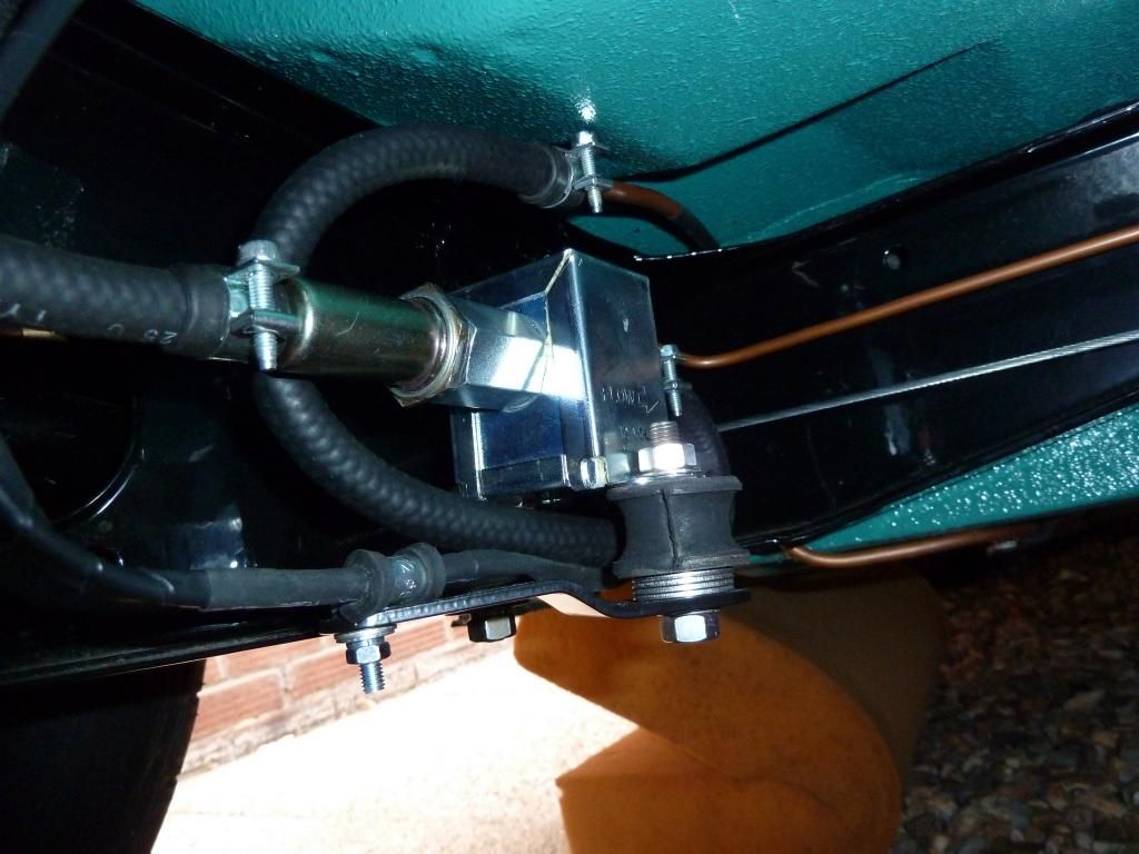

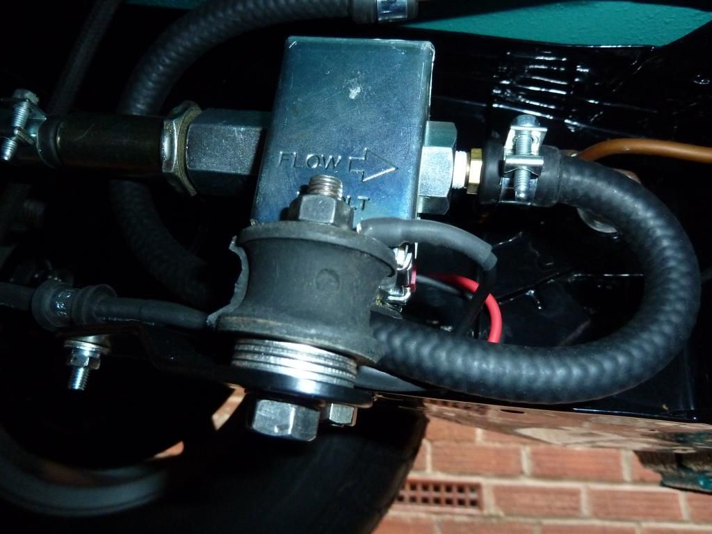

Hi,
As promised, a couple of pikkies of the pump installation
As the Principal states, you can use the "signal" from the oil pressure switch to fire a relay which will cut the power to the pump in the event of an accident.
My inertia switch was from a Landrover I think, picked up off of Ebay for a song. They're quite expensive new.
When I bought a new wiring loom for my Mini, I opted for an alternator loom with the ignition switched feed for a heated rear window. Since my Mini doesn't have a heated rear window, I used this feed to power the fuel pump via the inertia switch!
A little hint with this switch.....to make your Mini that little more secure and theft proof once you've parked it up, open the boot lid and give the switch a sharp tap. This, as in an accident situation disables the pump and any would be thief won't get far with your pride and joy on whats left in the pipe running up to the filter/regulator and carbs!
To make the pump run again, simply press the reset button on top of the inertia switch!
As before, I've mounted my switch near the top of the rear seat back-rest panel.
Hope this helps, Steve
From the pikkies, you can see the pre-pump course filter bolted directly into the pump and the routing of the fuel pipes to and from the pump. I also rubber mounted the pump as they can be a bit noisy!
