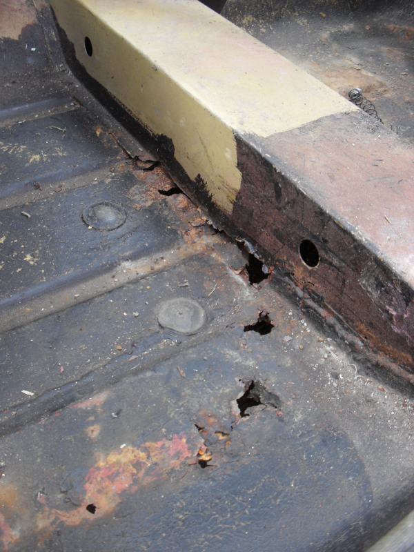

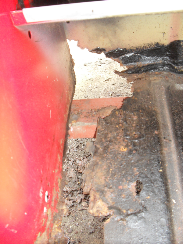

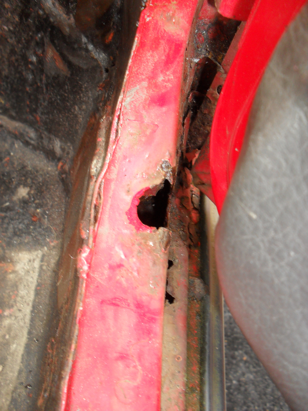

So now I'm left with a hole in the drivers side floor pan, from pretty much front to rear. This reaches all the way back to the heel board and rear subframe mounts. There also appears to be holes starting at the front of the drivers doorstep, and the seat crossmember has also corroded along the bottom edge where it meets the floor.

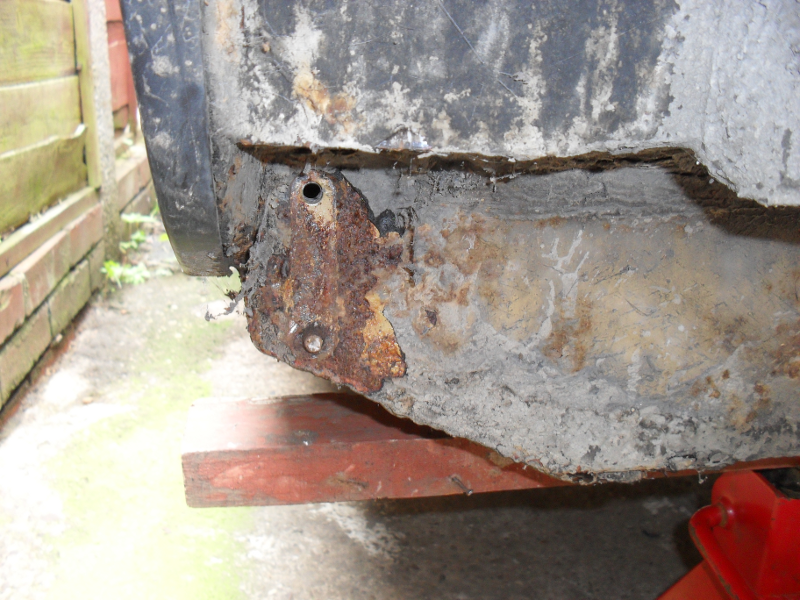

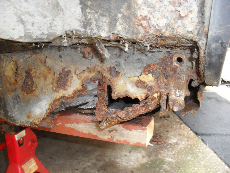

The rear subframe has been removed to inspect the mounts, there's nothing left of the drivers side, but the passenger side still seems pretty solid (although it does have a snapped subframe bolt stuck in it now). So im not sure wether to just patch the one side with an end piece, or replace the whole heel board.

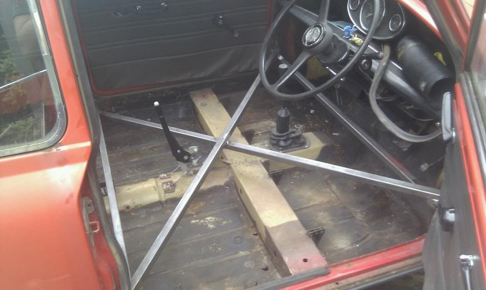

I have already quickly tacked a brace in place, but not sure it will be enough.

I think i would go for the floor first myself then the heelboard. That floor is shot and if both sides are as bad as each other then it may pay you to think about a complete floor.
The heelboard i would say replace as a complete unit rather than the two ends. it again looks very rough.
A lot of it depends on your budget to be honest and your skills as a welder.

Personally i would start with the heelboard, but while you still have the exisiting subframe holes then make up a jig using the existing holes as you will need to keep things square
