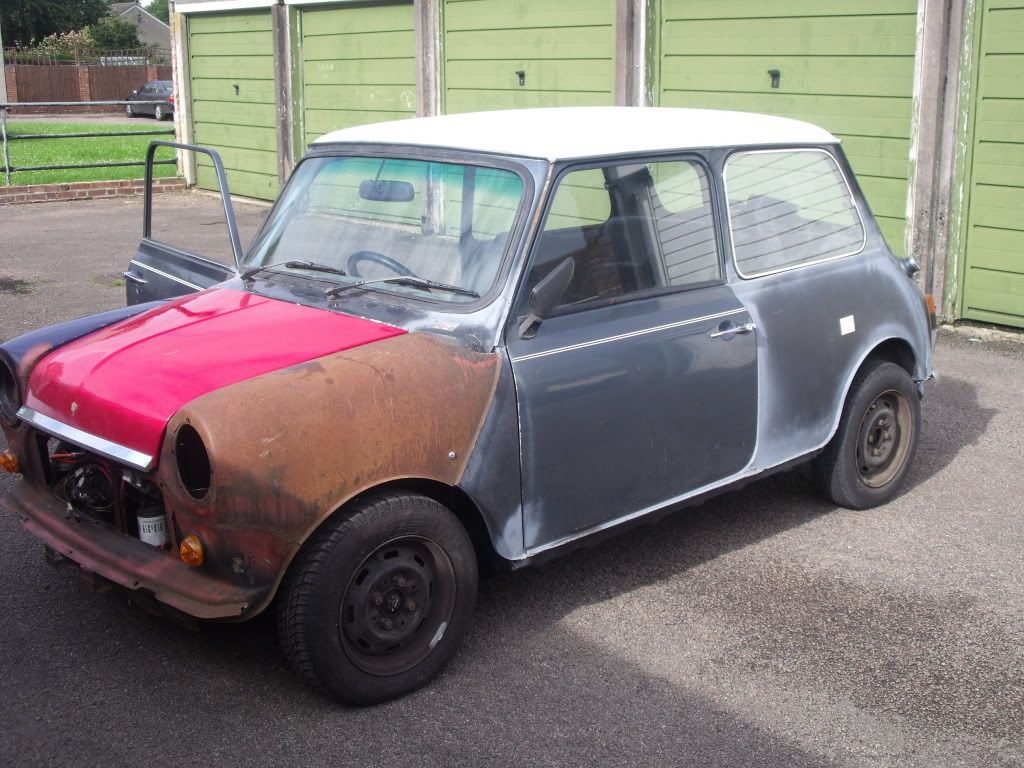

Hi guys, im gonna be roller painting my car with rustoleum next week as a very cheap alternative to spraying to keep the rust at bay, and so she's in all the same colour (as apposed to looking like Elmer the elephant) like this: >_<

and here is mine in RAL 7001
What colour mini are you after?
