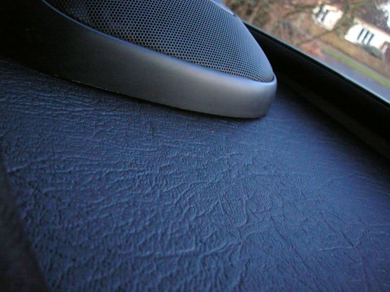

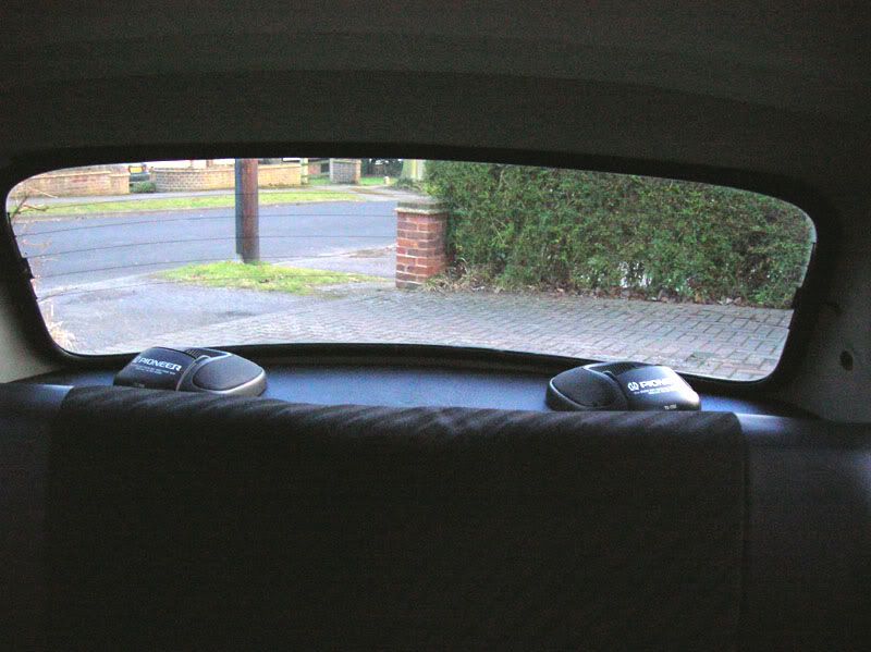

After purchasing myself some rather lovely new designer seats :) , the pale grey parcel shelf in my chelsea just looks WRONG. How easy is it to remove? Should it be covered or painted? I want to do some stuff myself *rolls up sleeves*
The O.E Shelves are rubbish anyway! Flimsy Naff bits of cardboard!
I made this one by pulling some 3ply from a skip, removing the old shelf and using it as a template, then attacking with a jig-saw.
I havn't got round to covering this yet, but it does have advantages over the original:
Its somwhere to put speakers
It cuts down road noise from the boot area
It looks better (or it will when iv'e covered it :D )
Tip for anyone doing the same though: (as i found out to my frustration)
Its better to fit the speakers/sub to the shelf before you put the shelf in, 'because you cant get a good screwdriver between the shelf and back screen! (not a problem if your back screen is out during a rebuild)
Hard to take a good pic of though!
Al
