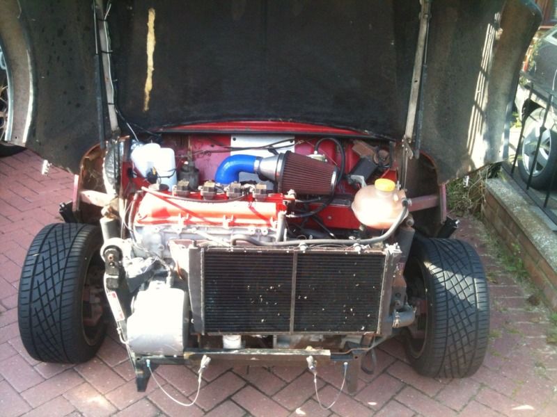

My mini currently has a 1pc "Lift Up" style flip front like this...
Problem is all of the fixings are visible from the outside and i can't open just the bonnet which is sort of annoying when all you want to do is fill the washer bottle up!
I have bought a 2pc front end which I am going to fit but it will not be a flip front. The bonnet will open as normal and the front will be removable for when I need to work on the engine and like you plan, all of my fixings will not be visible from the outside.

I think it takes a bit of creativity to get it all to work but I am sure there is a way you around it.
