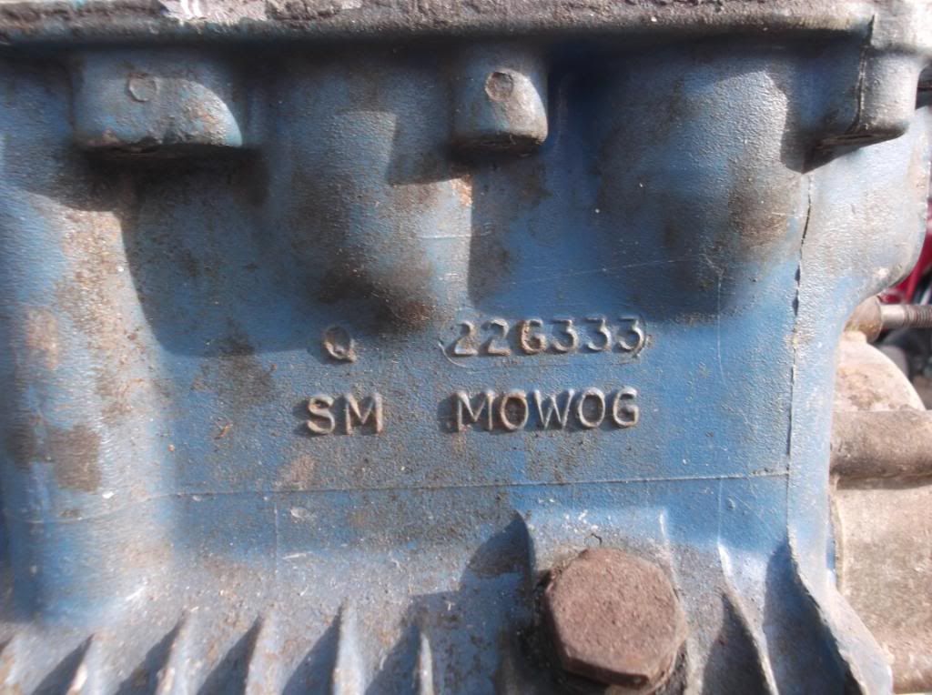

I took picture of any numbers/letters on the engines and gearboxes. I tried the gues works site but can't figure it out. The both have a 12A in the block, so am I right to assume they are 1275 A+ engines?
Attached File  engine1.jpg   75.3K   15 downloads
Attached File  engine2.jpg   165.98K   9 downloads
Attached File  trans2.jpg   283.72K   5 downloads
Edited by TA2DMAC, 14 August 2012 - 11:56 PM.
#8 JVA10L
JVA10L
  • 181 posts
  • Location: Lanark
Posted 15 August 2012 - 07:57 PM
They are definately not A+. The 10H791 engine is from an 1100cc Clubman. The other engine with the 22G68 G/B casing is a very early 3 synchro box but with the 1100/1300 remote and the 1100/1300 engine mounting plate so it is probably from an early Morris/Austin 1100 (did they sell them in the US).
