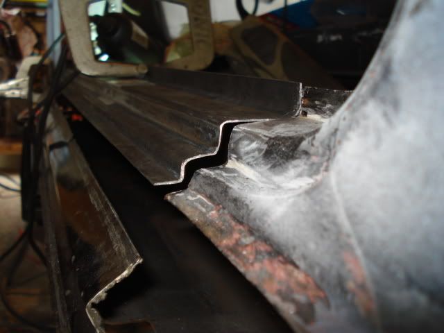

This is the one i made from scratch, first part in place
finished item bar some grinding
This was the other side and the better fitting one??
and after i had finished with it
and this is what i had to do to get it to fit properly
and this was how bad the l/h side was before i made my own. Total pants

Ahh then that is a problem. We have a large folder at work which is how i managed to form my sections. If you want to go down the route of making your own then i would suggest you find a local machine shop or somebody will a suitably sized folder, give them the dimensions to enable them to form the two parts. then tack weld them together before you install it in the car and finish welding it all together.
It is very difficult to fold it all in one section and believe me i tried
