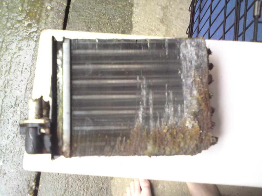

It does sound like the matrix has gone and its a simple job to take apart. There are two screws just behind the center dash, undo these and the heater should drop down. You will have to disconnect the fresh air pipe to the right of the heater and the demister pipes and then when its hanging down you can disconnect the live and earth cable.
Disconnect the two water pipes, there will be some water to catch so a container will be needed.
At the back of heater are two hooks so you need to lift the back up to unhook. There is also nut that you may have to undo depending on whether its been tightened up or not.
Once you have the unit out take off the side plate and pull out the matrix. It will be obvious if its knackered. A bit like this
This had not quite got to the point of leaking on the carpet but when i took the heater apart the water was starting to leak out. And i got a lot of steam out of the vents when the engine was hot.

...Or like this!!
Mine was leaking out into the carpets and producing steam out of the demister vents (actually more of a "mister" than a "demister" in fact!! >_< ). Be prepared that by the time it gets to this stage, it will probably have been leaking away for some time. So don't be surprised if the inside of the heater casing has corroded quite badly when you come to remove the matrix, at which point it might be time to strip it down, overhaul and repaint it. (or just replace it with another, if you're feeling lazy :D )
