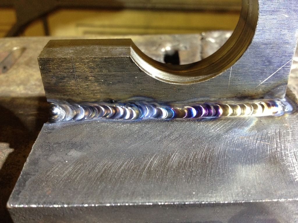

ey guys,
been doing a bit of tig welds. did quite a bit welding some beads but didnt take any photos,
what do you think of this? please be critical i need to know exactly what i am doing wrong, personally i feel i am going a little to fast etc and i know there are wobbles in place,
also please note i stopped half way along
#2 danie garry
danie garry
    I love BMW minis
  • 2,296 posts
  • Location: malmo
Posted 14 September 2012 - 07:19 PM
that looks good to me, learnt a bit of tig not so long ago, very easy to get a pretty weld but it can be a ******* to get a good strong weld! that looks pretty good though!
#3 miniQ
miniQ
  • 497 posts
  • Location: Manchester
Posted 14 September 2012 - 09:56 PM
Looks good. Especially if that's your first time. A few mistakes... but something time will fix.
What you planning on TIG'in? Or just fancy learning/having a go at it?

#4 tiger99
tiger99
  • 8,584 posts
  • Location: Hemel Hempstead
Posted 15 September 2012 - 12:22 AM
The weld looks very good, as far as it goes, and if just for welding practice, is one you should feel quite pleased about. If it was on thinner plate it would be very nearly perfect. However, on such a thick piece of metal, you would need a much larger fillet for full strength. That is no criticism of your TIG technique, just that what you are welding is very thick. You would fairly easily build up a bigger fillet by putting two or three runs down, side by side, on top of what you have done. You would need to weld the reverse side too, of course. Of course, not everything needs the full strength that the material thickness is capable of.
#5 JonnyBMX
JonnyBMX
  • 865 posts
  • Location: Bedfordshire
  • Local Club: Rebels
Posted 15 September 2012 - 11:42 AM
Will load some more pics up! Yea tiger I need to get hold of some 3mm all my plates 1.6mm or there abouts! This was litrally just a practise never TIGged b4 in my life but I'm okay at mig abd arc do thought I would bite the bullet abd buy the ac/dc TIG, planning on welding stainless zausts and me abd my m8 have some plans for some polo gearboxes :) anyways will load some more pics shortly

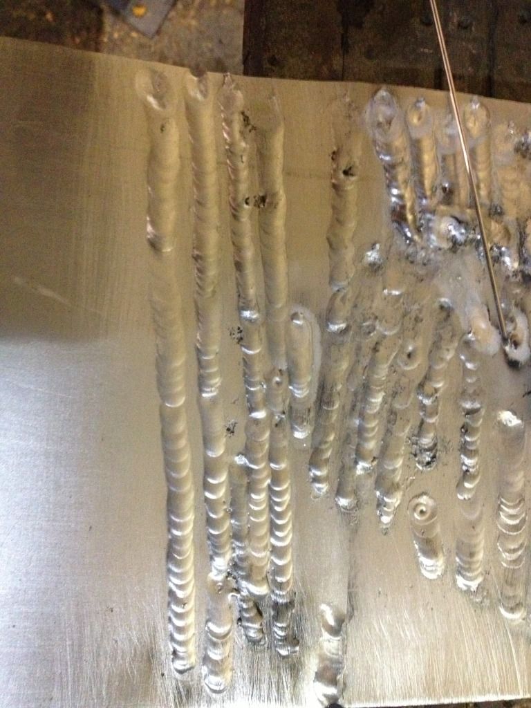

been doing a bit of ally,
ignore the top half what you think?

#9 antcole
antcole
  • 307 posts
  • Location: Devon
Posted 23 September 2012 - 07:52 PM
The tig is a beautiful weld once perfected.
The pic in the original post is lovely, theres something very satisfying with a nice smooth weld. Looks great mate.
As long as the penetration is sufficient, the only knack is perfecting even pools and a nice straight line.
Practice makes perfect, i think the tig is under used.... although its not the most practical in those tight, hard to reach areas.
Edit* and spotlessly clean fresh metal to weld to.... :-)

#11 tiger99
tiger99
  • 8,584 posts
Posted 24 September 2012 - 08:56 PM
I like the look of those! There is something about TIG and ali, the welds just look right somehow. You don't get that with any other process. MIG leaves a lot of spatter.

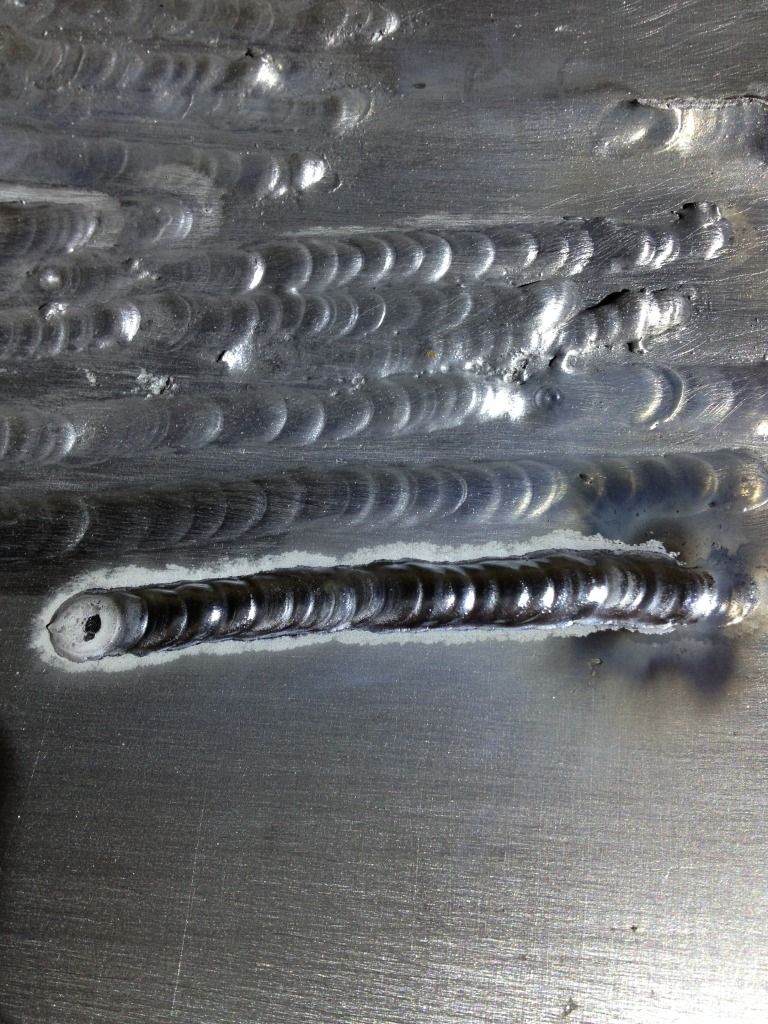

Posted 28 September 2012 - 12:36 PM
more practise
