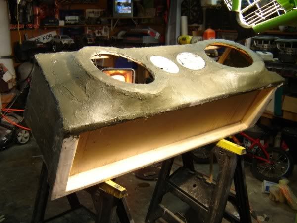

You could do a fibreglass top panel if you wanted to make it look a bit different (HERE is a pic of a build from a guy in the US...just as an idea)
Then you'd want a front end to match...you're a little limited on space in a Mini so it might be easiest to just stick with some 6.5" components (kick builds perhaps, then tweets wherever sounds best to you)
