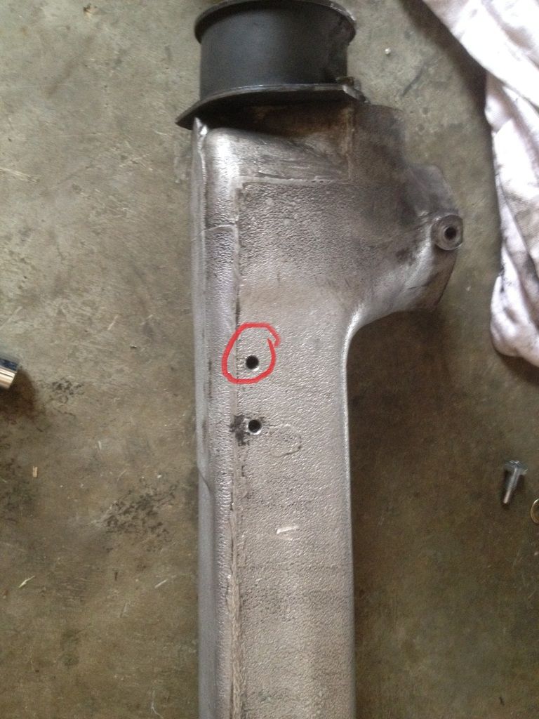

I tried the search function but couldn't answer my question so here goes. Please forgive me for being a newbe but I have a 1967 Austin Mini Cooper S with a manual trans and for some reason I can't get into reverse. I have removed the remote and cleaned all the trash out and noticed I was missing the Locating Pin as per the Haynes. I have since purchased a new pin but now I have two holes to choose from. I assume it's the one circled as the other one was plugged with grease. You can just about see the missing pin in the right hand side of the pic.
Two questions:
Is the locating pin what everybody is calling the roll pin?
Would the lack of this pin cause my issue with reverse?

No, that is not the roll pin, which is found on the rod change remote. Yours appears to be the old style (and much better) remote.
I believe the locating pin, if it is part numebr 2A3602, actually goes in the hole at the top right of your picture and engages with a groove in the ball to prevent the gear lever spinning. I would think that without it, you could have more problems than just reverse.
I suspect that the hole you have circled and its neighbour are an unofficial modification.

Thanks Tiger, I'll put it all togher and give it another try...

can you get the the gear stick through the reverse 'Gate' or does it crunch or just refuses to go in gear? has anything changed to cause the lack of reverse like new gear stick or did it suddenly happen?
Here's a pic - http://www.scparts.c...le_vertikal.tpl
Looks like the locating pin is laying by the side of the housing

I get a click when it passes the gate and then nothing. I reversed out of the garage and drove maybe 5 minutes and then tried to back into a parking stall. At that, no reverse. But I do have an after market shift lever that appears worn where the locating pin is suppose to hold it. Could this be the issue?
