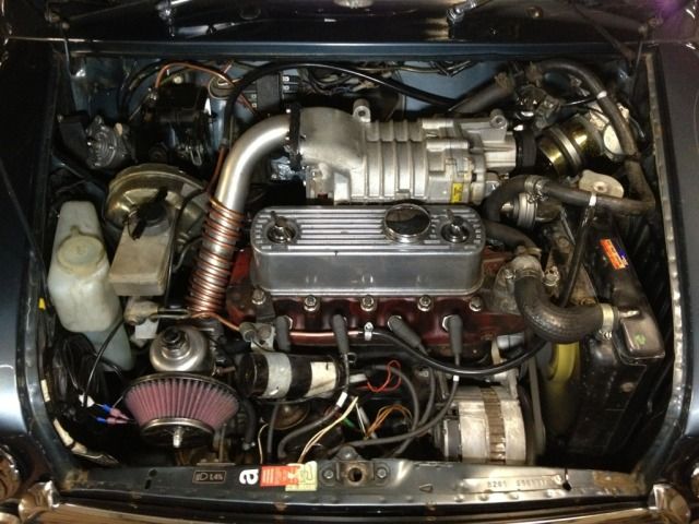

#8 Nick Warwick
Nick Warwick
  • 1,588 posts
Posted 19 September 2012 - 01:49 PM
my copper pipe set up
Got my heater element off www.rs-components.com
item number 299-5843
Edited by Nick Warwick, 19 September 2012 - 01:53 PM.
#9 maccers
maccers
  • 1,875 posts
  • Location: Epsom
  • Local Club: LSMOC
Posted 19 September 2012 - 02:39 PM
Thanks Nick - so the copper pipe connects to the coolant system.
Where did you place the small electric heater?
