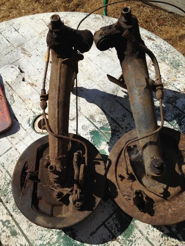

Of course - the 'original' arms may have been changed already..... do they appear to be fabricated - with a weld line visible?

Just as an example, here is an early welded arm next to a late cast arm. The early arm would be late 59-late 60 or early 61 I believe, These ones came off my Jan 60 car. Differences in the earlier 59 arms would primarily be the hand brake cable had a tube instead of the quadrant.
