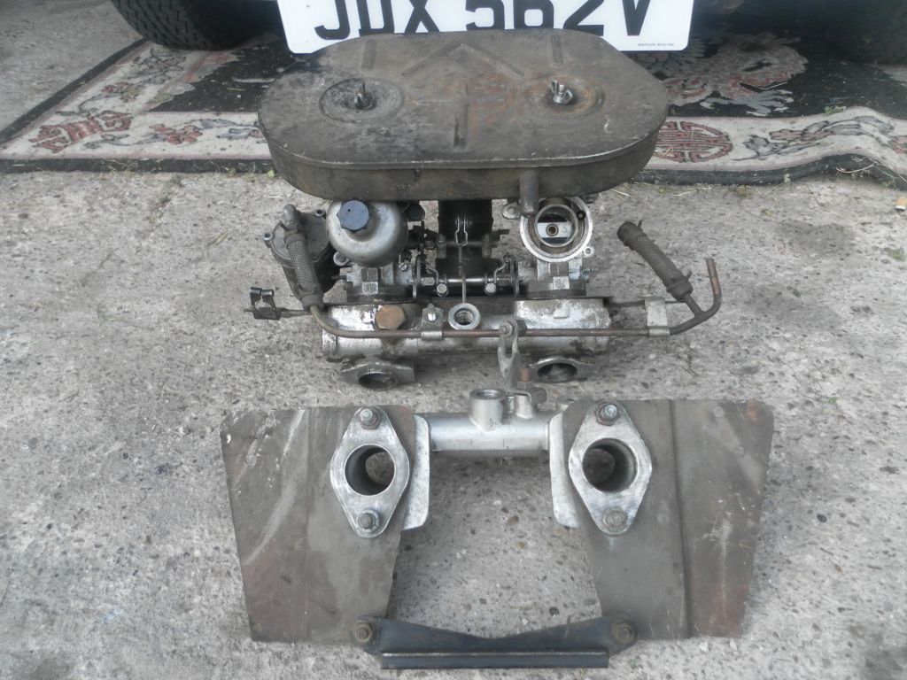

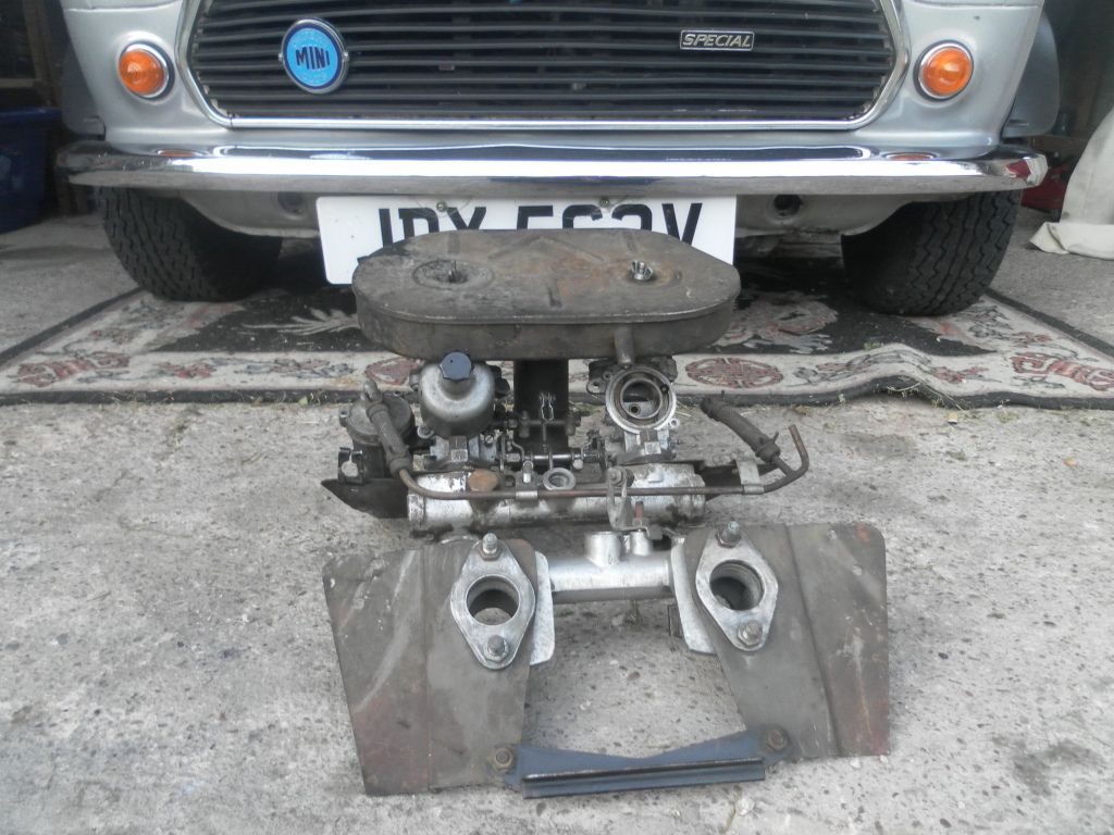

i picked these cooper s carbs and airbox up today for a bargain price, the carbs were incomplete but i only bought them for the airbox anyway.
the guy even gave me a spare twin carb inlet manifold as well

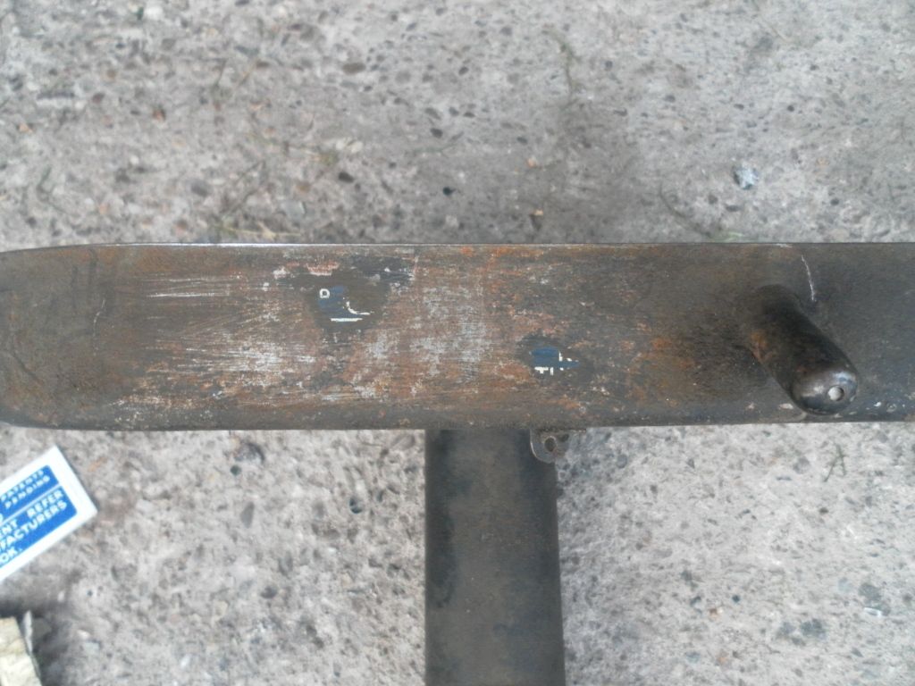

you can still see the remains of the old "coopers" air filter sticker

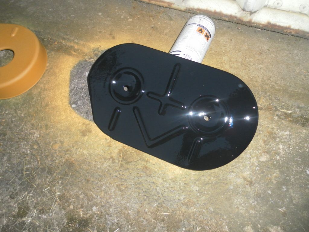

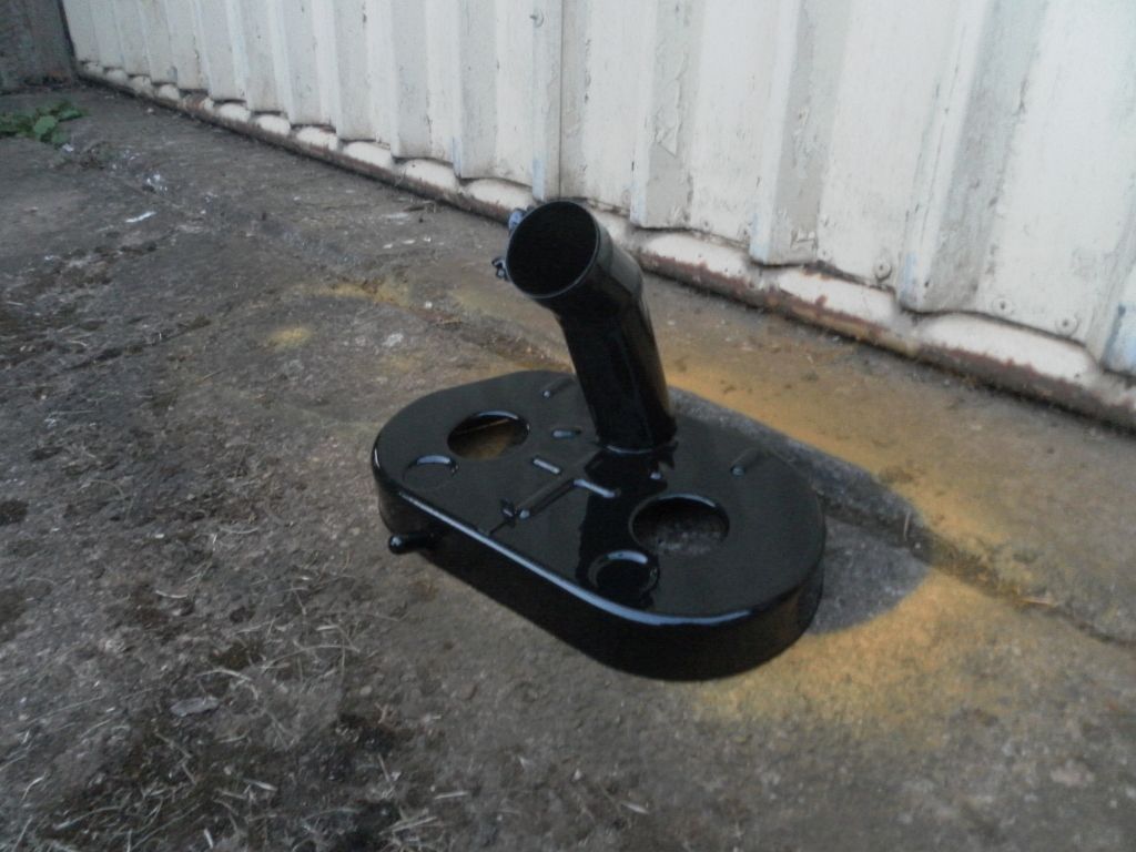

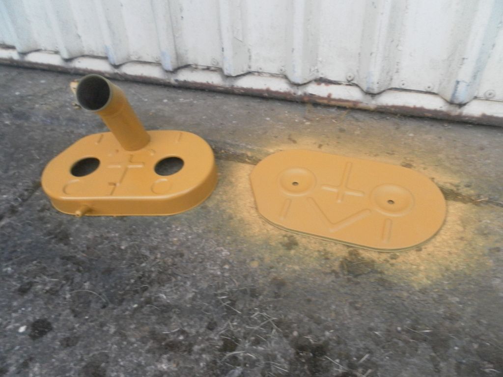

i gave the airbox a good rub down then applied primer and finally a top coat of gloss black enamel

there only 1"1/4s matey
the carbs to have are the hs4 twins not the hs2
hs2 s are ten a penny

Twin HS2's are great on a 1098 so long as you have a gas-flowed head and, maybe, a better cam.
You will need a float chamber by the look of things.

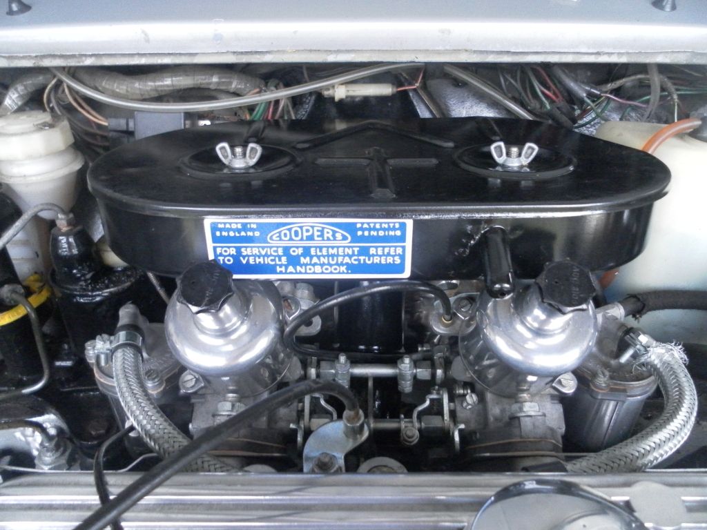

the engine will run much better in the colder months with the standard airbox, and also to prevent any chance of carb icing which i encountered with the K&N's on the way to bingley last january

If you are wanting to sell the carbs I might be able to find a float chamber, but you'll need to get the fuel pipe from base of float chamber to the jet base.
PM me if I can help.

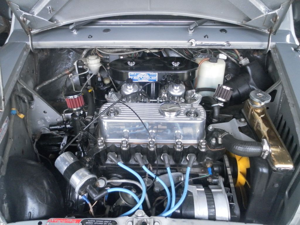

i finished the airbox this morning and fitted it to the car............i think it looks quite good!
notice that one of the rocker cover T-bars is missing, i wondered what that BANG was when travelling back from derby yesterday.....more rubbish parts from min-its, i'm getting fed up with taking stuff back to him now!
