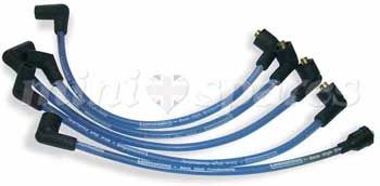

I've got a 1275 A+ with a 59D dizzy, with electronic ignition, i've got a set of these leads
http://www.minispare...ch/classic/plug
100% silcon translucent outer sheath, 8mm lead set with stainless steel wire spiral bound wire giving instant and greater resonance, Kevlar fibre core and a ferromagnetic layer for EMC suppression by Luminition. Top end of ignition lead sets.
with BPR6E Plugs
are they gunna be a good match?
Trac
