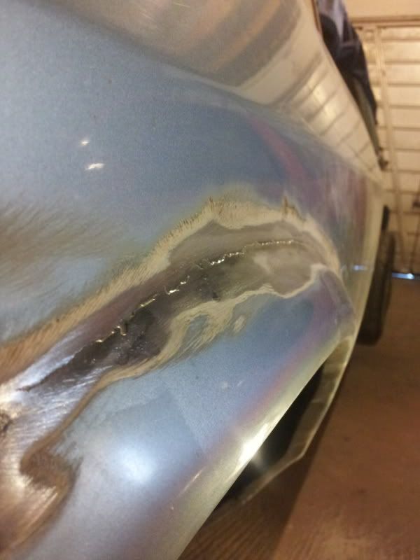

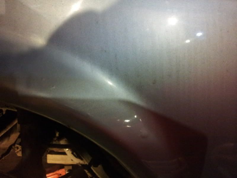

I had a full respray, 2 new rear arches, 2 new rear lower quarter panels a bit of a repair under the bonnet behind the headlight, a tiny scuttle repair and a repair on the drivers door near the hinge. The car looked great for about a month until the paint started to micro blister allover the roof which they fixed. I had problems with the paint ever since, fast forward 4 years to 2009 and every horizontal panel on the car had blisters on it, even the bonnet which was brand new & still packaged when I gave it to them is covered in thousands of micro blisters, he did try to blame the old paint underneath but the bonnet is brand new and was still in it's factory primer. One wheelarch has bubbles in the paint allover it and the other is starting to distort where it should meet the inner arch, the rear lower quarters have started rusting badly the door is worse than it was in 2005 and there are bubbles appearing where they repaired behind the headlight. The scuttle is also a mess.
The car came off the road in 2009, in 2011 i started stripping it down, learned how to weld & got stuck in myself, here is what I discovered-
Bubbles in a "new" panel?
Anyone want some bodyfiller, i appear to have plenty!

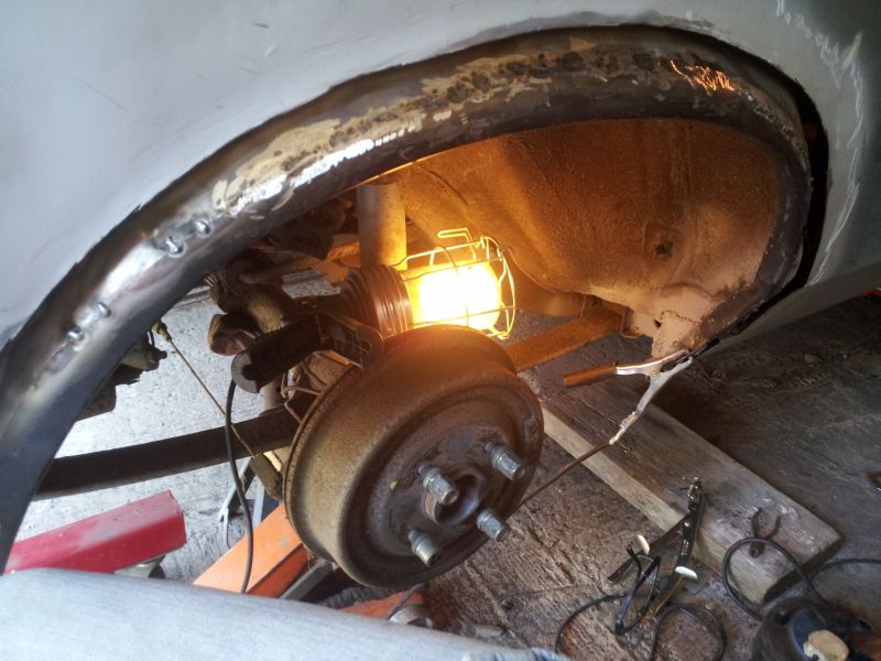

Is that the inner arch there that is crusty as hell? No that's the original arch that they appear to have ground back to bare metal, there were actually shiny unpainted parts of it under there still, so they hadn't even primered anything, there was what looked like the ramains of a body filled hole in there which had grown in size massively towards the front of the arch.
I think when you are repairing an arch you are supposed to make it look more like this-
Maybe actually replace the crusty inner arch lip!
And then maybe actually consider welding the new arch over the clean NON RUSTY inner arch like so.
I thought i'd post pictures of the repairs in-case they ever read this thread, they may learn something.
I'd add pictures of the pigs ear they made of the other bits too but i'd be here all day, it's a similar story with all their repairs though, leave the rusty metal there & just weld over it & then bodyfiller galore! To think i paid them £3700 for their bodge work! Pretty bad that someone who watches a few welding videos on youtube can go out & chuck £300 at a mig welder & do a better job than a "Professional".
