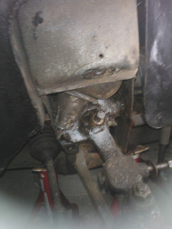

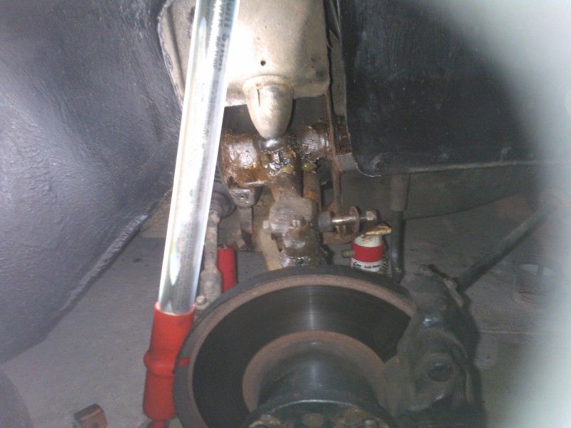

1. Take what looks like a perfectly good Mini. (which actually has "sagged" suspension..).

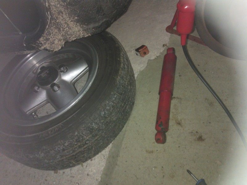

2. Remove wheel, Shocks and rebound rubber...
3. Locate f#ck~d suspension components.

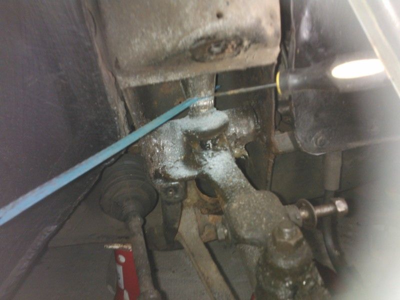

4. Saw through trumpet.. Take care now..
5. Remove

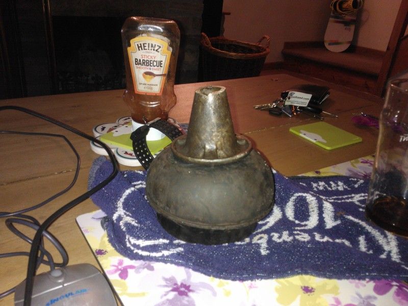

6. The root of all my problems... A bent cone??

Well I do have the tool, but it didnt work because the old cone had become mishapen (last pic) so the thread didnt match up.
With the new one, Yes will compress with tool.. And I can shrink the hilo - so should fit in with ease. Gonna rebuild the upper arm first though. Then attack the other side.

cone is mis-shapen as its been put in the subframe wrong and hasnt located in the 'ring' at the top of the tower..
will prob find this ring to be pretty battered now and will need to be bent back into shape so the new cone can locate in it correctly....
