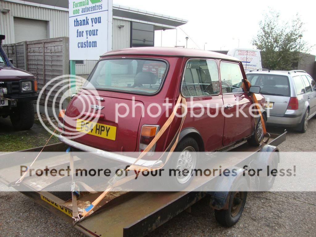

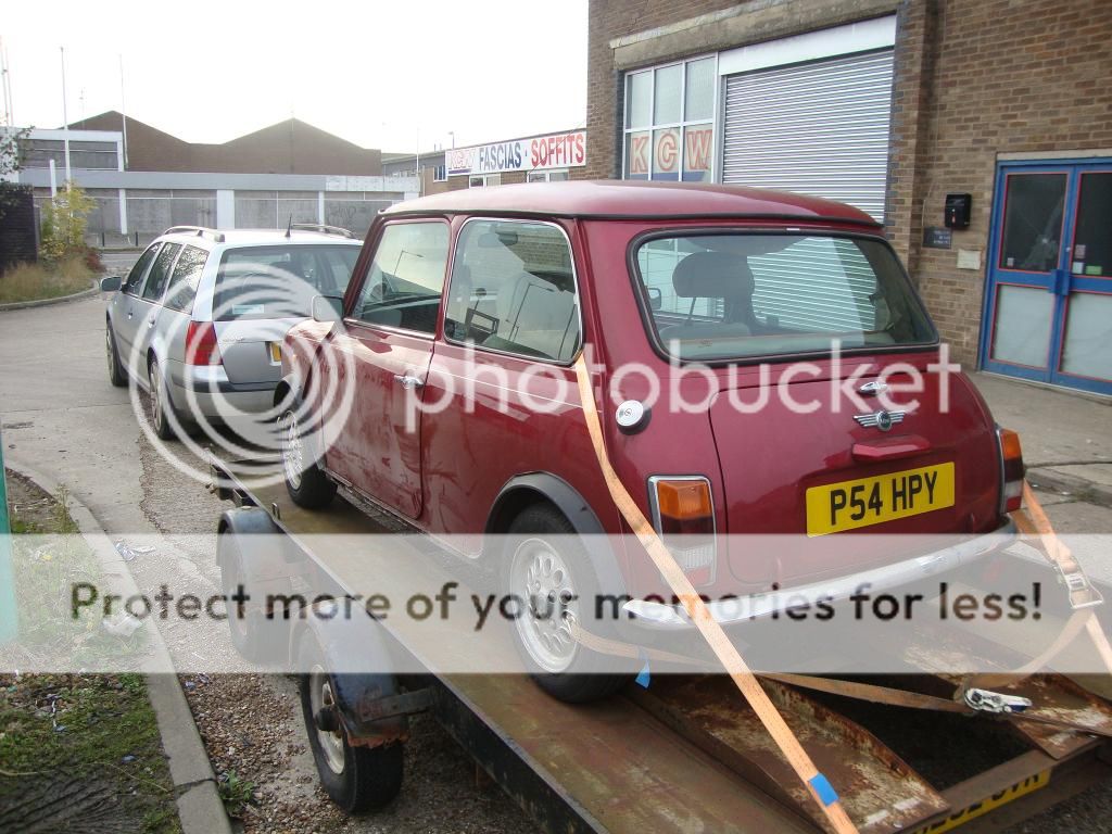

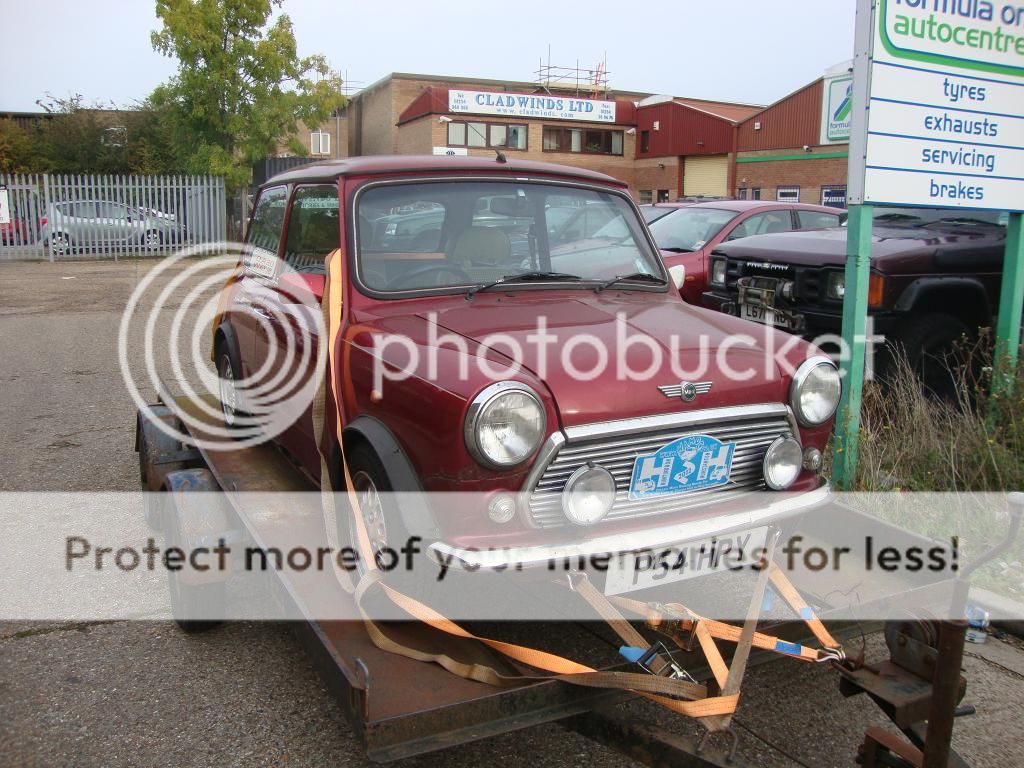

This is how I do it..
Through the rear windows at the back(with an additional safety strap)
Then though the tie bars at the front(with a couple of extra straps)
I like to put a few on the front, I really don't like the idea of the car coming off the back of the trailer. A Safety chain between the trailer and the towbar is essential. I once had a boat come unhitched from the tow car and nearly went through Kwik-fits window!!

Posted 23 October 2012 - 09:20 PM
That's a Brian James trailer just like mine. Super stable which can be towed at any speed.
I strap from towing eye to front with a ratchet strap and use the winch on the trailer on the other side.At the back I go through the towing eye, if there is one, or round the back of the rear sub-frame on each side if there isn't. Never lost a car in years of towing all over Europe at very high speeds.
