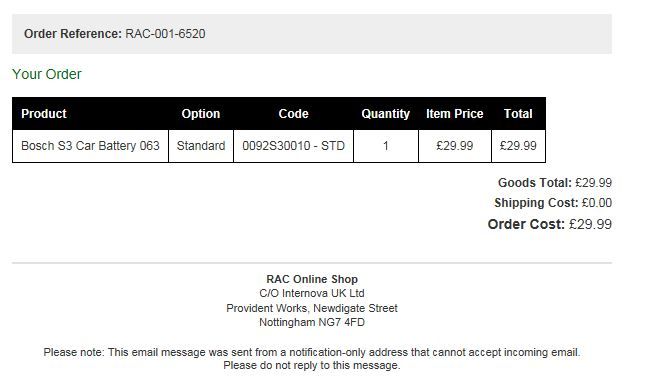

Posted 01 November 2012 - 03:57 PM
sorry looks like they don't sell that battery anymore, i literally ordered it last week heres the invoice
trac
