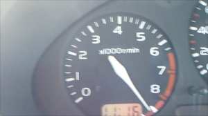

Refined and 9k A-series screamer don't sit comfortably do they ? Do you really want to spent about 4K to build an A-series that will rev to 9000 rpm, that is hardly going to be refined.
A Micra engine be it a 1.0L which will actually rev to 9000 rpm without internal mods or a 1.3L one are both going to be refined, not massively powerful and cheap as chips to buy. You'll end up with exactly the car you're looking for. I'm amazed you've not spotted it to be honest.
%C3%98yeblikksbilde-1-10.07.2013-20-27-3
to make an A-series do the same you
needhttp://www.swiftune....piston-set.aspx

Thanks for your comments Artstu.
I have had yet another think about it, if I were to fit a different engine I would go Honda VTEC.
That Micra engine is fitted to a LHD car. To fit this into a RHD drive car would be even more problematic due to brake master cylinder clearance issues. It also looks like he hasn't finished the project.
The Swiftune bottom end set is for a 1275 which is a longer stroke than a 998. It's harder to get a longer stroke engine to rev.
