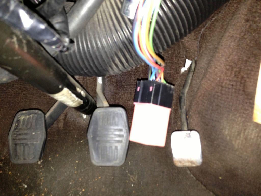

Okay, I have a 1987 Mini Mayfair and a few months ago when coming back from work my rear lights and dashboard lights would not turn on but my head lights would both side and full beam (i only found out the rear ones didn't after drivers flashing me) but since that night I never had an issue until this week. Again the rear lights won't come on nor will the dashboard lights but the headlights work still.
Now I had a look today and pulled the switch out of the bottom dash but that all seems fine, so I then rummaged around under the dash and found this, I don't know what it is supposed to do or whether it has any relevance to my problem.
Any help is appreciated, also yes I have checked the fuses they are also fine.

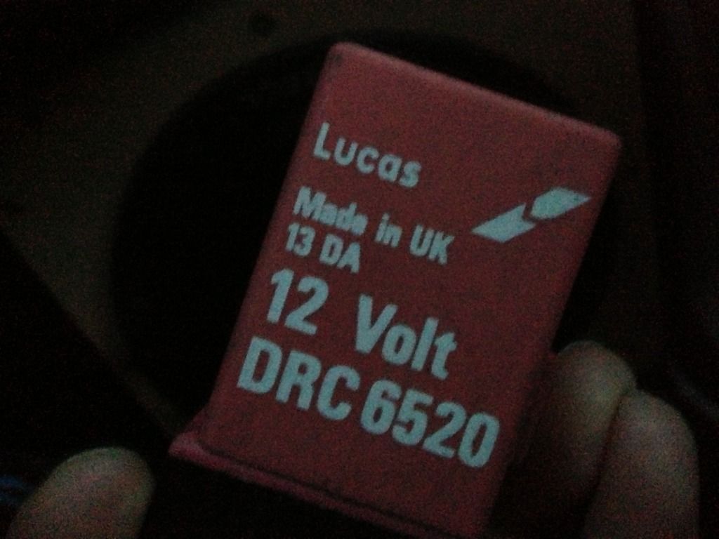

That looks like the relay that does all the lights, I had an issue with mine with various problems with the lights, turns out that relay was goosed. Replacing it fixed the problem, as they're fairly cheap it could be worth a shot.

The tail lights and instrument panel lights are on the same fuse (usually the bottom one in the fuse box) so check the fuse and the connections there, as the fact that both the tail and instrument lights are not working points to the problem being something to do with this fuse. The headlights are not protected by this fuse, so will still work even if this fuse is blown.
The large pink relay pictured is the dim/dip headlight relay and shouldn't be connected to your problem, as the headlights are on a different circuit and the dim/dip relay is protected by a separate fuse.

Once again we have had bad electrical advice, concerning a mysterious (completely illegal) relay which controls all the lights, and correct advice which says that there is no fuse in the headlight circuit, except for the dim dip.
Your problem is probably with the fuse which has red and red/green wires attached. The red comes from the light switch, and the red/green divides several ways to go to the side and rear lights. It may be an inline fuse, or in the box, depending on model and year. I am trying to encourage people to become more familiar with the wire colours, as they are consistent on all Minis, and even if the Haynes manual does not have a diagram for your exact model, using the nearest available diagram and comparing colours will generally get you to the problem.
As for the dim dip relay, it is an abomination which is not required (the anticipated law never was introduced), and as it can cause failure of the dipped headlights (NOT any other lights!), it is best removed, and its blue/brown and blue/red wires permanengtly linked.

The OP's problem is definitely most likely to be the fused circuit indicated by Tiger, and i wholeheartedly agree with taking the dim dip out of the equation as suggested. This relay makes for 90% of the lighting issues i have to deal with on Mini's. Bridging the two wires gets the problem solved in most cases, but i usually strip the loom and remove all the extra wire involved in this circuit. I know it is not necessary to do so, but it make fault finding a lot easier in the future rather than chasing wires that go nowhere!
