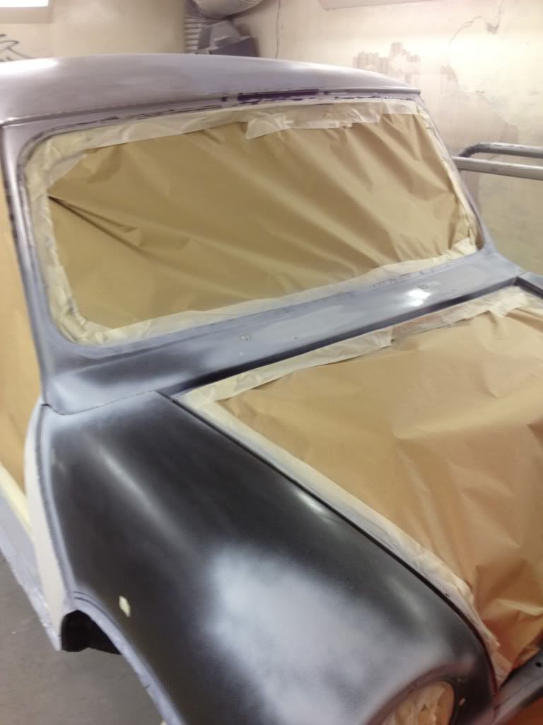

as above just go round the ouline with masking tape then paper across and masking tape it down again just keep the masking tape off the bits you want to paint
as im not on a pc where phtotobucket works i cant see if these are the right ones, but thats how i masked my mini up
http://i1113.photobu.../maskingup1.jpg
http://i1113.photobu.../maskingup2.jpg
http://i1113.photobu.../maskingup3.jpg
http://i1113.photobu.../maskingup4.jpg
