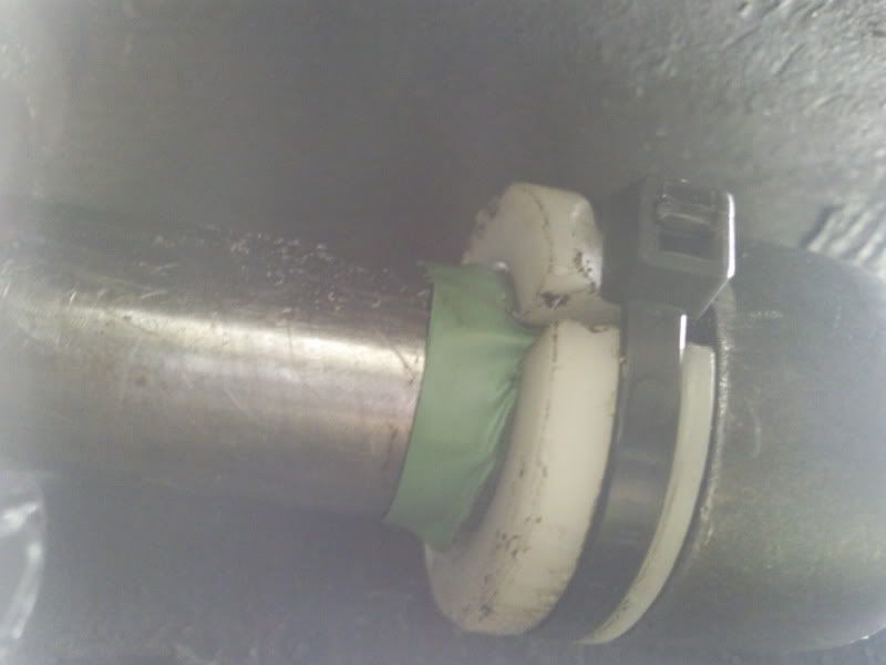

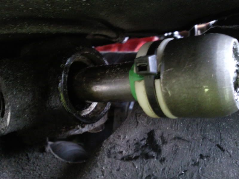

#6
Posted 19 November 2012 - 08:53 PM
Found these pics...
#7
Posted 19 November 2012 - 09:08 PM
The rack has been centralised & slight marks on both calipers.
Thanks for the pic's Jordie. I reckon I could get some machined up out of Teflon & fitted to the rack. The actual lock is pretty good & would only require fairly small amout of spacing to cure the problem.
Probably easier to get standard tie bars first & get a full geometry done before taking the steering rack gaitors off.
Certainly would cure the poblem though.
Many thanks for your help.
#8
Posted 19 November 2012 - 09:12 PM
You just undo the boot clip and slide it back.
But yeah getting it setup would be the best option, if the problem persists these may help.
Jordie
