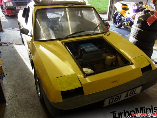

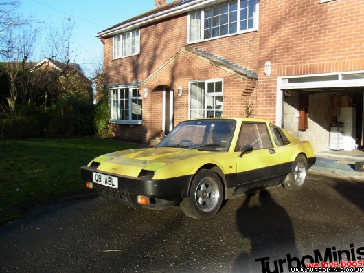

Work to prepare the car for Le Mans 2013 starts today.
I bought this car a few years ago and used it for one summer. Fundamentally I could drive it to Le Mans tomorrow, but there are a few thing that I want to sort out:
1) move the steering wheel to make it central to the seating position
2) Modify the throttle pedal for a better position
3) Make a cowel for the intercooler to make it useful
4) Make covers for the headlights (the ones in the photo are cardboard!
5) extend the sill line to the wheel arches
6) Fit boost control
7) Fit mapped ignition
8) make a decent engine steady
The basic car spec is a full GRP shell with mini rear subframe, suspension, engine etc and Viva front suspension. The engine is a metro turbo, totally standard.

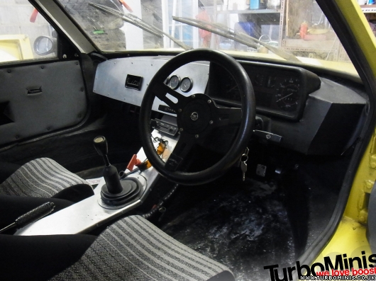

So progress made. First thing to do was to move the steering wheel. The guy who built it put the steering wheel off centre, so a couple of new brackets and some fettling with the hole where the column comes in and it's in pretty much the right place.
Next I moved the wing mirrors. They were on the main part of the door and not much use and looked odd. Now moved up onto the window frames. These may vibrate a bit more, but I'll deal with that if it's problem.

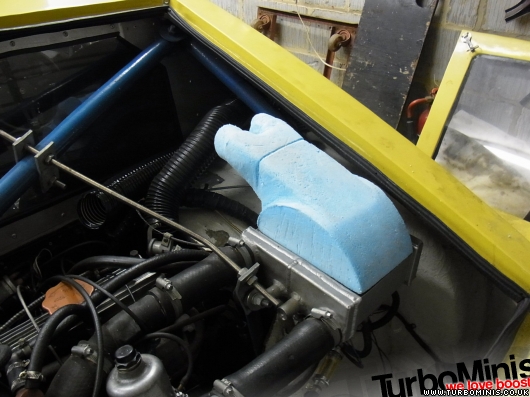

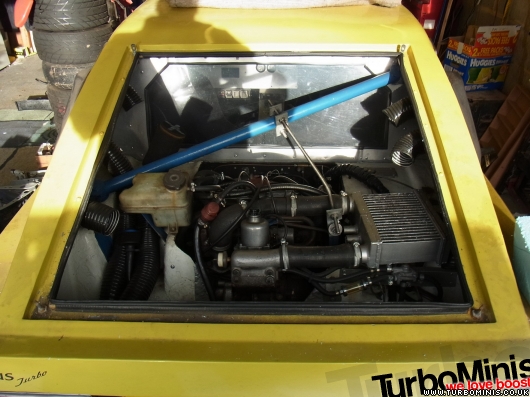

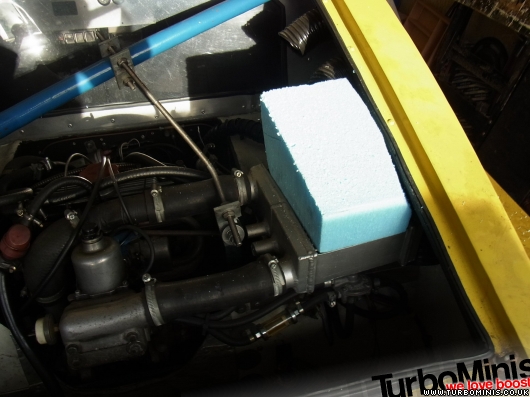

Now it's onto the intercooler. There is no real airflow to the IC. Ideally I'd like to fit an charge cooler, but I don't have the time inclination or money. So my plan is to make a fiberglass cowel to get the air from the side intakes through the IC.
Looks like this now
This is my basic shape in foam. a bit of sanding and smoothing and the addition of an inlet or two to go.

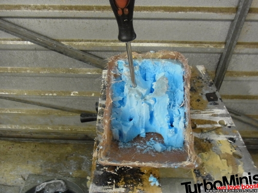

A bit more progress.
First make a mould using high density foam.

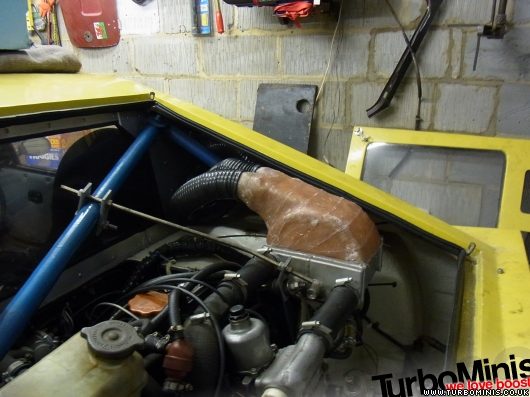

Then lay it all up and remove the mould
Jobs a good one. Needs tidying and painting of course. Should make the IC of some use though.
