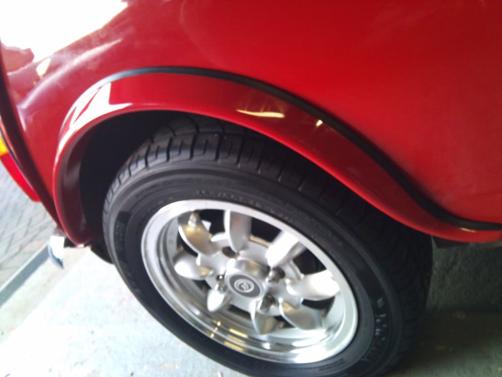

iv got discs at the front and standerd drums at the back and i would get the arches from wood and picket i dont want to do any cutting

Is this your car? It's stunning.

i would go arch less and just stick some chrome or rubber trim on there

This

Surely you would need arches to cover 12x5's with disc brakes, otherwise the tread would be exposed and be illegal? I realise it depends on the offset to a certain extent, but surely you struggle to get any 5 inch wide wheel under there without it scrubbing on the inner arch.
