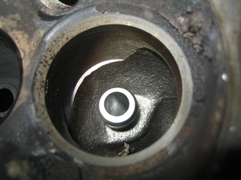

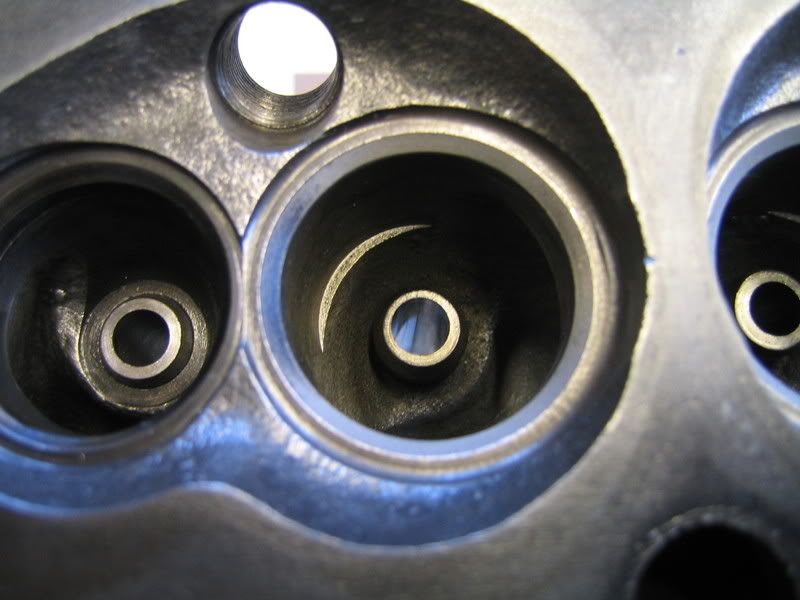

Posted 06 December 2012 - 10:08 PM
Ahhh man i thought this stem had to have a groove, no my actual valve guides havent got a groove in
Attached File  image.jpg   64.99K   15 downloads
And i have some of these already
Attached File  image.jpg   69.16K   5 downloads
So that means my head never had these then, and i guess i can't unless i get new guides
But if I'm not smoking I'm fine without you all think?
Edited by Club man, 06 December 2012 - 10:11 PM.

once you replace the guides you should also get the seats re-cut.
#8 Club man
Club man
  • Just Joined
  • 130 posts
Posted 07 December 2012 - 09:07 AM
Right, understand now and take it new valves as well with new guides?
#9 ACDodd
ACDodd
  • Mini Docs
  • 2,765 posts
Posted 07 December 2012 - 11:03 AM
This is one of the reasons that valve seat cutting is neccessary after guide changes, more prone to later heads;
The OE guides are not centred when machined, consequently changeing them for a new item will mean the seat will not be concentric with the valve. Result no seal. If anybody contemplates changing the guides without seat cutting they MUST CHECK THE SEAL using parrafin or similar after the work is complete.
about 80% of the heads I work on need seats cutting after guide work.
AC
Edited by ACDodd, 07 December 2012 - 11:03 AM.
