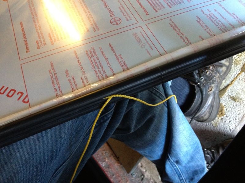

Ive done that conversion to my project but using perspex instead of glass
You will need to remove the old window by removing the self tappers and sliding it out backwards and remove the old seal as well
Get the fixed window type rubber and fit it around the glass
Then you will need to get some strong string or cord and push it into the other slot in the rubber
thread it all the way round and place on the bottom seam/edge of the window frame with it pushed well into the one corner
then its a case of pulling the cord up and towards you lifting the rubber over the frame edge around the whole window
When its in place give it a good shove from the outside to make sure its pushed well onto the body lip, then your done
