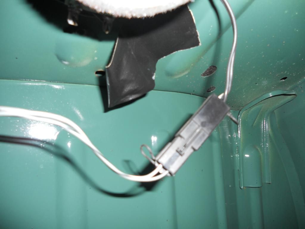

I want to replace my parcel shelf speaker but it has a unusual connection. How to i wire up two new ones.

if you wanted to use the existing wiring, just cut of those connectors and crimp on some new ones.
