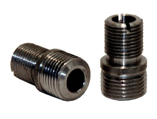

This is not necessarily going to be a helpful suggestion unless you have access to a machine shop.
As a point of reference, the Triumph 1500cc engines have an oddball thread for their filters also. The standard "fix" for this is to fit an adapter nipple in the block. It adapts the smaller threads in the block (perhaps 5/8-UNC) to the much more common 3/4-UNC threads used on a lot of filters. If you can figure out what is in the block (using calipers and a thread gauge) you could make or buy an adapter (bushing or nipple) so in the future you could use more readily available filters.
To give you an idea of what I am talking about, the picture below is the filter adapter nipple.
http://images.oreill...e/wix/24037.jpg
