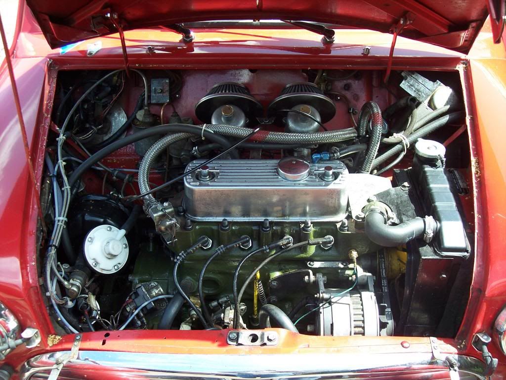

Yeah the head will be sent off to be done and so you guys think twin hs4s yeah okay thanks guys any one got any pics of set ups

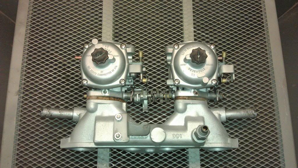

#7 Cooperman
Cooperman
  • 23,326 posts
  • Location: Cambs.
Posted 17 December 2012 - 10:04 PM
These are twin H4's, not HS4's, on a Mk.1 1310 cc Cooper 'S', but the installation is the same as are the carb sizes.

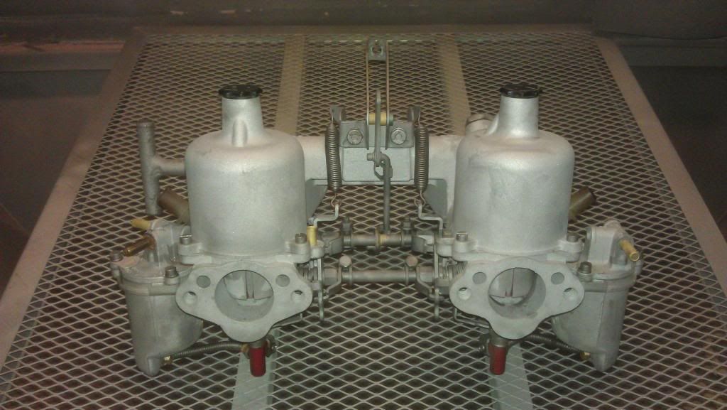

h4's
hs4's but on a triumph manifold
and don't rule out 150 strombergs

Okay thank you guys looks a nice little set up one question would i have trouble fitting twins if i have a brake servo
#10 Wigeon Incognito
Wigeon Incognito
  • 294 posts
  • Location: Essex
  • Local Club: Essex Mini Club
Posted 18 December 2012 - 09:09 AM
No it's fine, the RSP S has twin carbs and brake servo.
