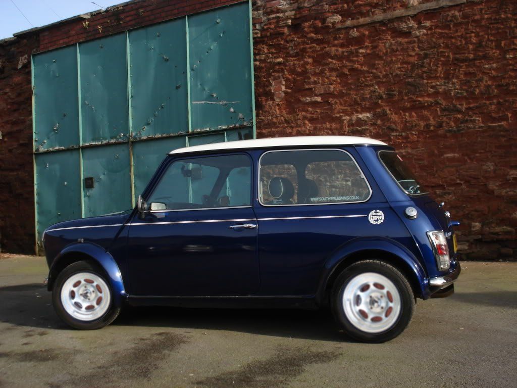

I will be picking up my Mini in the next few weeks, and it needs new tyres. It currently runs on the stock steel 12x4 or 12x5 wheels, which ever it is. Instead of spending the money on tyres for wheels that I want to change out anyway, I figured it would be a good time to get new wheels. I am on a budget with this, and Mini wheels are expensive here in the states. I wanted to go with 13'' wheels, but I found these wheels for a steal-
They are 12x7. Yes, that's right 7'' wide. I know it will be hard to find tyres for that, but I work for a tyre shop, so I am not too worried about that. I also thought about stretching a set of 165/60/12's on them. It would be very minimal stretch since the tread width of a 165 is 6.5'' and the wheel is 7''.
I think that they will look good on a Mini with Sportpack arches, but I am looking for opinions on them as well. Should I go with these at a fraction of the cost of 13x7's, or should I hold out for the bigger wheels.
These are the 13's that I originally wanted-
The 13's would cost me around $1500 (£930) + shipping with tyres, where as the 12's with tyres shipped to my door would be $770 (£475) And that is if I went with the more expensive tyres. If I went cheaper it would all come to $600 (£370)
Anyone on here have 12x7 wheels? If so, could you post pictures and tyre sizes? Thanks.

Well this is my Mini, it's a 95 spi. Still needs a good bit of work and rust repair, and will not be staying silver.
I just did a quick photoshop of the wheels on this Mini (same colour and wheel arches that I plan on going with)-
I think they look pretty good on that Mini. This really helped my decision, haha.

They look fairly epic....

Yeah I think that will suit the sportspack look, plus as before, they are different (i'm not sure how much that applies over there as minis are much less common than here), if your happy with the stretch and safety aspect of the rims, then i'd go with them!
