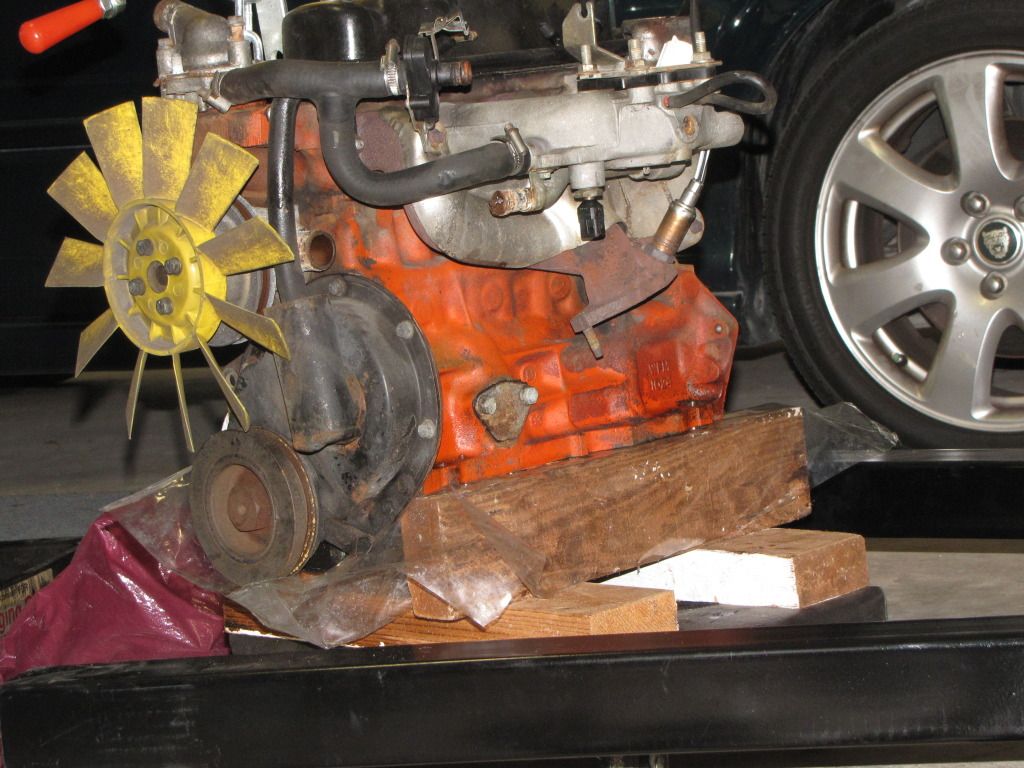

It is possible too that there is some gunk in the water lines of the manifold that reduce the flow to the sensor. You could try something else first. Drain the radiator and disconnect the two water lines from the manifold. Get from an auto parts store two pieces of heater hose about 1/2 inch id and about three feet long with two clamps. Connect the two pieces of hose to the manifold water lines with the clamps and then use a garden hose connected to one of the hoses to flush the lines. Then reverse the flow through the other piece of hose. That might solve the problem if it is clogged up.
You can see the two water lines and the sensor in the centre of the picture:
