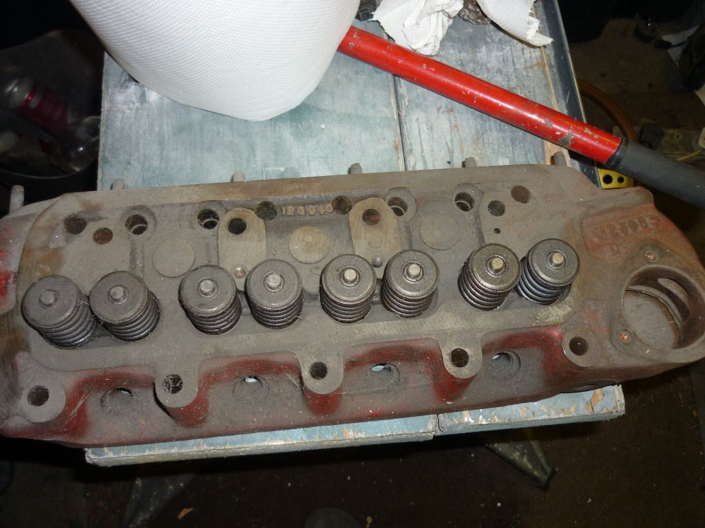

#7 1275GTS
1275GTS
  • 668 posts
  • Local Club: bmc
Posted 29 December 2012 - 02:26 PM
This is my early leaded mg metro head.
