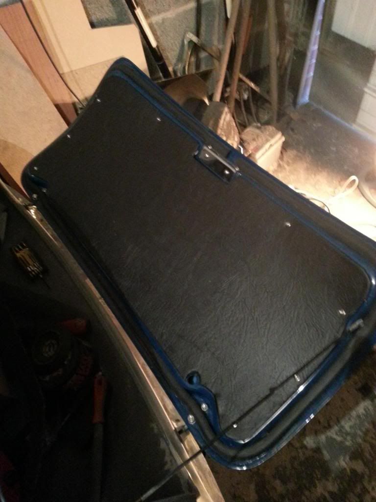

made one of these!!!! only took a couple of hours and i think looks pretty darn smart..;)
cheers james

It looks really good!
It would stop the paint getting chipped and rusting too!

yea il do a guide when ive got 5 mins..;).... but was very easy.... hardest thing was sticking the vinyl down

Did you use any backing or is it just vinyl?

i used 4/5mm fibre board as it bends easy with the different contours of the lid the just wrapped it in vinyl with spray adhesive.. fastened it down using ally riv nuts and m4 stainless allen head nuts with spring washers so they dont vibrate loose
hope this helps

next step is too make a pocket so i can put my jack and tools in so they dont skate around in the boot.. :D

nicely done. i got one similar a few years back and theyre great make it look nice and smart and tidy. Pockets on them are good too for a few tools water bottles etc. But theyre really good for hiding any rust on the inner of the boot lid too ;D

no rust on mine as of yet as its freshly painted..;)...but give it a few months lol

A good coat of waxoyl behind the cover would help stop the rust
