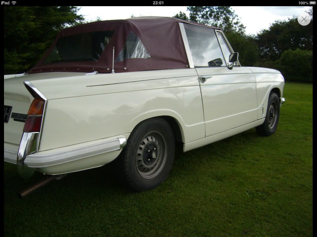

For interest, my current car is a Triumph Herald, if Roy (bmcecosse) sees this, yes, i went back to Triumph!!

A yes -didn't you have a Triumph before cally?? Is this the same one ?? One day you will move up to a proper Triumph....the TR7 ! As for the jumping out - unless it only started after you fitted the seal to the gearchange - it is indeed likely to be the dog teeth on 2nd... just tell the owner not to do 'over run' in 2nd gear! You could just check the two rubber bobbins supporting the gear lever box - if these are soft they may allow the lever to be pulled out of gear....but it is clutching at straws i'm afraid....

Different Herald Roy, the old one was a crusty estate, this one considerably less crusty!
Can't handle the tax on a TR7!!!
