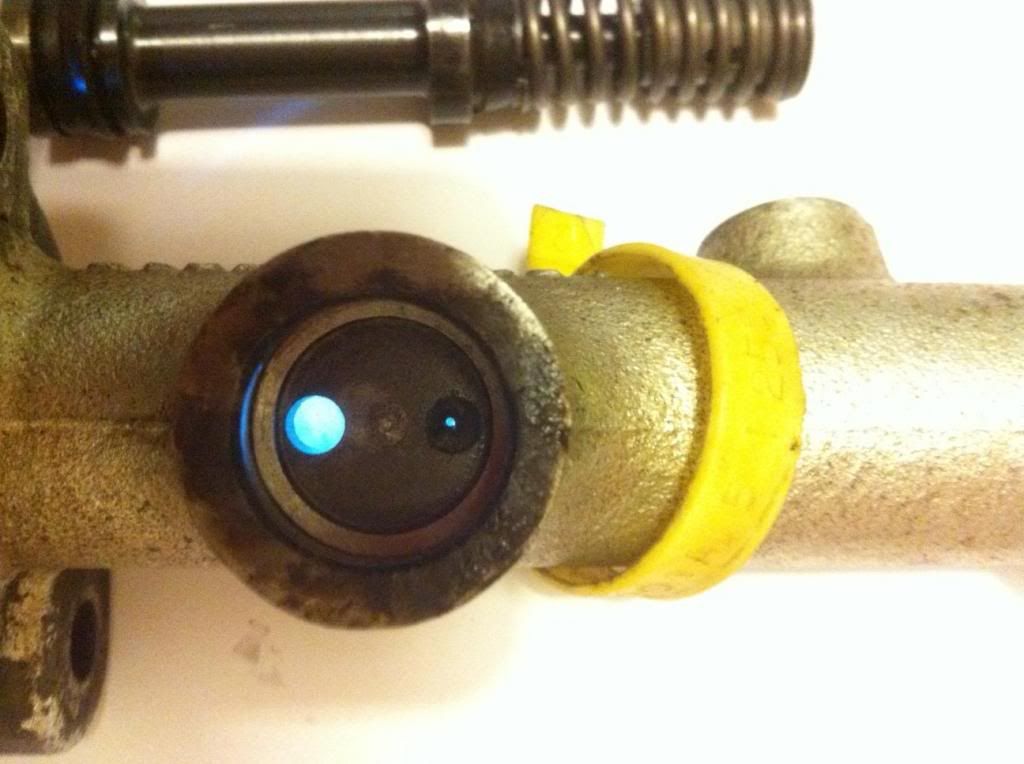

Posted 17 February 2013 - 11:28 PM
This look similar to the Yellow tag item
there is no path from the small inlet hole to the top of the rubber i belive
the rubbers must have increased slightly over time or the original clearance (determined by the washer at the base of the unit held in by the circlip) was tight to start with
im going to replace rubbers and replace the thick washer (19) with a thinner one.
IC

Posted 06 March 2013 - 10:53 PM
BRAKES NOW WORKING :D
i bought GRK1035 Repair kit and rebuilt and all is fine...
Cause looks like the rubber seals had swelled and moved far past the smaller hole in the Cylinder
the cause is most likely the small matter of me adding Power steering fluid into the master cylinder when i run out of fluid a number of months ago :ohno:
anyway the new seals are fine and Ezibleed fired up through all 4 corners, pedal came back, still a bit spongy but its fine for now.
you can see why i was struggling....... :lol:
