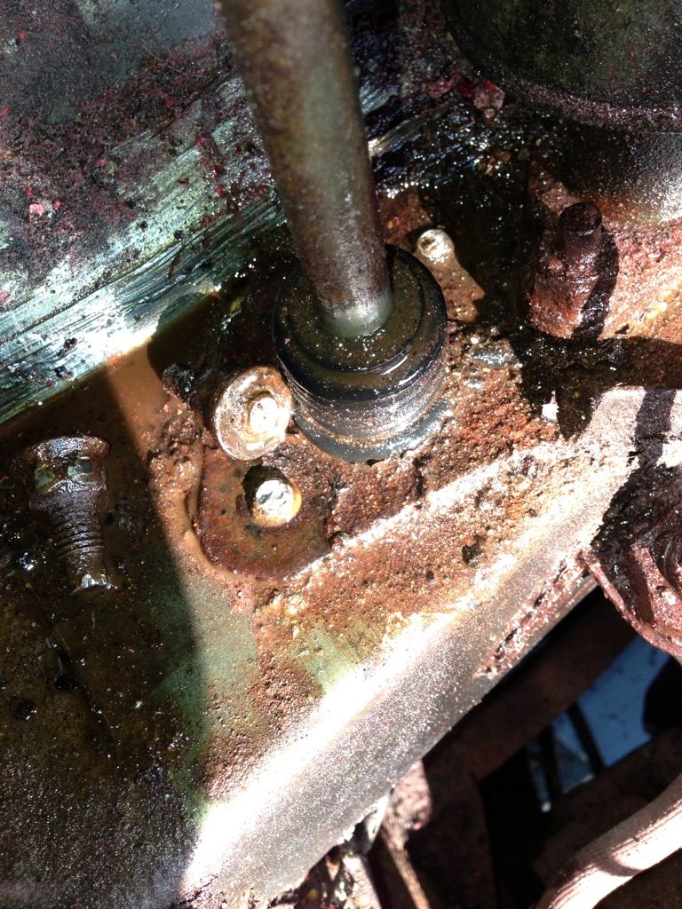

heres what I'm dealing with
going well so far
maybe toooo well ops what shall i do now lol?

hope this isnt serious :(

New pedal box?

Have to drill it out and replace the 5/16 bolt by the looks of it

It's a stud welded to the pedal box, shouldn't be difficult with the pedal box removed, might be worth looking at all 4 while you're at it.

May as well try the clutch ones while in there. For future ref. you don't need to remove the brake lines if doing a clutch or removing the engine. Those hard lines have flex enough to lay the servo up on the fender/wing

not the best at welding to be honest. and welding a stud looks difficult to get right
shall i just buy a new pedal box and chuck that in? are they cheap?

Take the box out, then off the car drill the stud(s) out. You can then put a bolt thru, tac-welded in place... Robert's your mothers brother, new stud. Simples.
