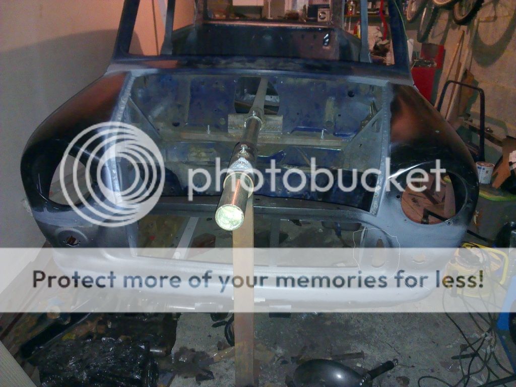

Trying to remove this...
Any tips would be great help :)

Need some more info on the car mate, is it a air intake for the air filter or the black air intake scoop for the heater on the r/h/s inner wing jusy behind the grill?

@kernowcooper i think its the air intake scoop just behind the grill.

The heater air intake. Pull the hose off the back of if under the wing, then twist it upwards so it rotates in its mounting hole. Then it will pull out. It's only pushed into place with a sort of bayonet fitting but it's not all that secure really.

Thanks Dan.
