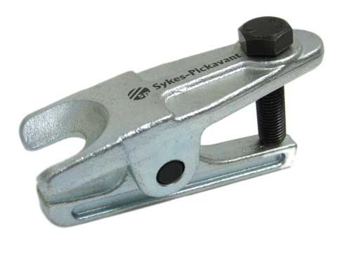

you need a ball joint splitter:
That should separate those joints from the steering arms. You don't need to remove the rack from the car to take the subby out.
