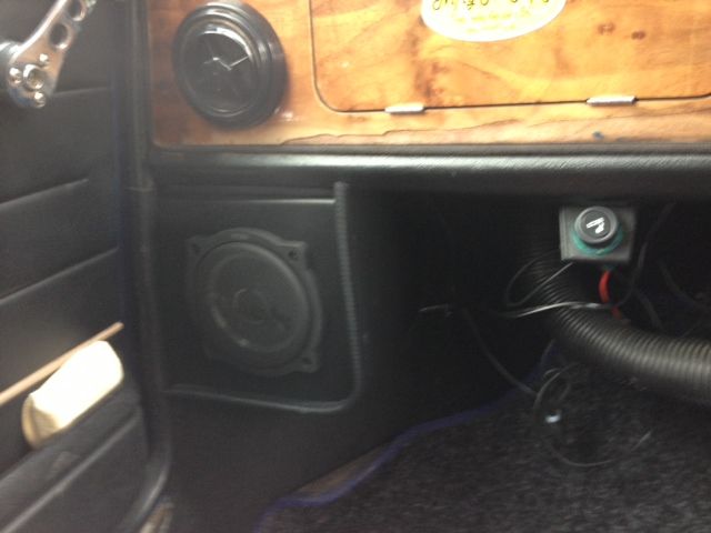

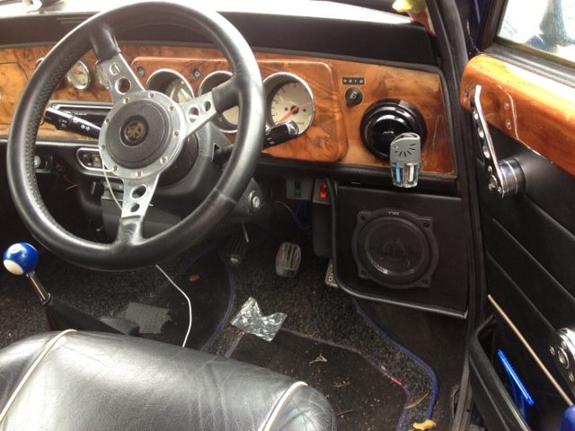

FINALLY they were a bugger but got em done, few pics, dirty car :/

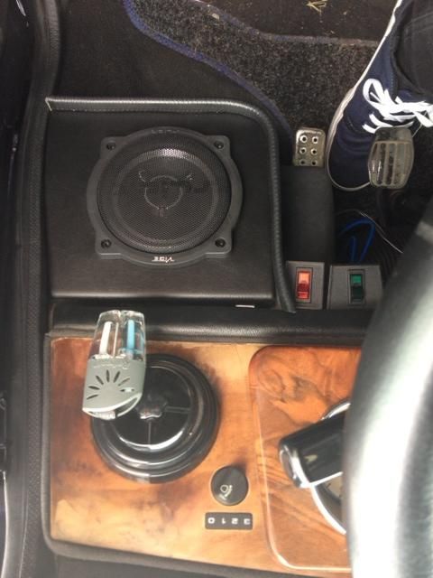

drives side isnt finished, has a bit of fabric to go between the speaker and dash.

They look good. Do they not impact your legroom at all?

sorry for the late reply... no lol not really once of twice mine gets a slight kick from my size 11's but other wise there fine :D

Since this an MPI, A pic of the re-located fuse box would help me a lot.
Pete
Pete
I just unbolted mind and put it up inside the dash.
I used some velcro to hold it in place, but it's not rocket sience.

on the drives side picture under my red and green switches...that little box is the fuse box. my pods had holes in it already and you use the screws already in it. you do have to move the boot release if you do it this way. But i got a bracket with them too to re-fit this (behind the red and green switches)
the only thing i didnt like doing, behind the speaker is a thin metal frame for the fuse box which means you need very shallow speakers, i just used a hack saw to cut through it and bent it back, so a 'normal' size speaker could fit :)
