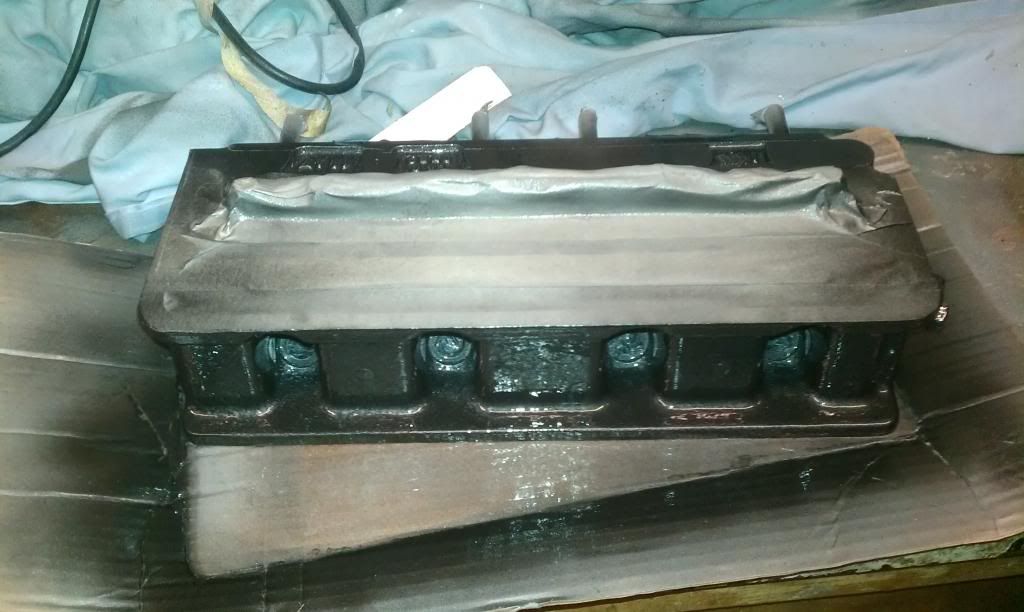

Masking tape.
Roll it up into balls for the spark plug holes and push it into place.
Lay flat lines across the mating surfaces and then with a sharp scalpel/Stanley blade cut out the shape, then you can get right up the the edge but not get paint on the mating surfaces :)

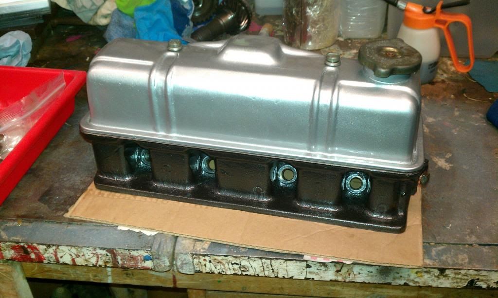

a word of caution with the oven, any oil residue will stink to high heaven and may taint any food, use a dedicated oven if you can (or if you fancy 20w50 roast beef)
as for masking do exactly what noah has said, masking tape and a sharp blade, you could even use an old set of plugs to block the spark plug holes
the lacquer was still wet when i took this picture and the flash has made it look really shiny which infact its not. and after a head cycle it matts down nicely. (standard automotive cans with a few coats of lacquer on top)
