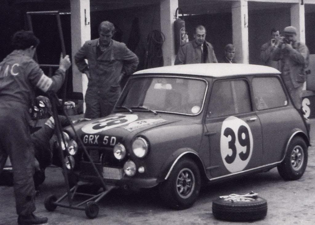

Maybe its just because I have had this car up in the air more then on the ground lately. I was thinking of a better, faster way to get it up and down. I currently have the wooden block for the front and that is really great BUT nothing for the rear. I would just love to be able to get the wheels off the ground 1-2-quick. All dealers sell these:
But none sell the jack to go with:-) I am sure I have seen a post or two on the topic but did anyone build their own and have pix? Would love to see how long (or short really) these are and how exactly they "clip" into the brackets above. Are there any issues with using these for more then just for that "Works" look? What do the current Mini Racers use?

It's just a big lever which hooks under the two 'Works style brackets' front or rear. It lifts the car and holds it in position (not very securely) by going past the vertical. To work easily it needs to be almost as long as the car so not really practical for anything other than pit-stops or use in your garage.

Thats a GREAT link. Thanks! Maybe this isnt for me then. Looks like you have to have a LOT of room for the jack itself and the forward motion of the car. Would be sweet to have though.
That thing is like 6 feet tall! I wonder what the shortest you could make it before it gets too difficult to operate?

looking at it... it looks like they wanted it to be 4ft long and had to add a bit!

Its all down to leverage as you've pointed out and is really a large version of the rear paddock stands used on todays bikes with no centre stands. I'd never find the room for one the size of the thing.

I was at an event a few years ago where someone turned up with a genuine works jack just like the one in the second picture with GRX 5D on the Marathon de la Route. None of the owners of replica works cars would use it but the owner of a genuine works car, which was a Mk 2 Cooper S, did use it on his car and it lifts it just enough for the wheels to clear the ground. I thought with a hydrolastic car it might struggle to get it high enough. The raising and lowering was no problem and seemed easily controlled.
